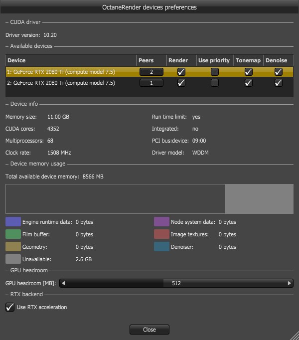

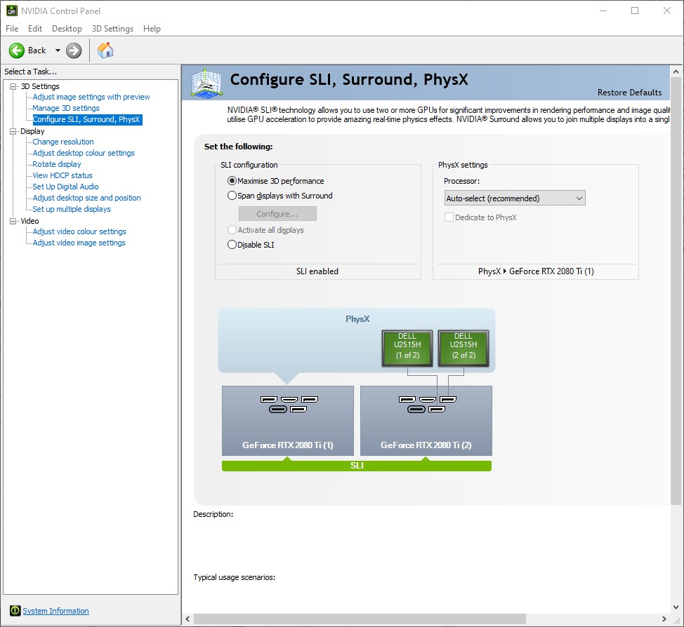

I'm using x 2 2080ti with a matching NVLink Adapter attached with the system correctly configured in SLI with Nvidia Studio Driver 442.92 installed and RTX enabled. I am also using Octane 2020.1-R2
I enable "peers 1 and 2" to allow for Octane to use NVLINK.

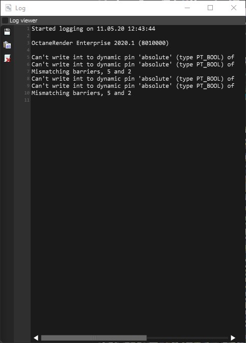

When I start the LV render, the image starts as expected. When I move the Camera for a while I get an error.
The Log then says "Mismatching barriers, 5 and 2"

If I disable Peers 1 and 2 the rendering works fine so I'm fairly sure this is related to NVLINK or at least my understanding of how to use it effectively.

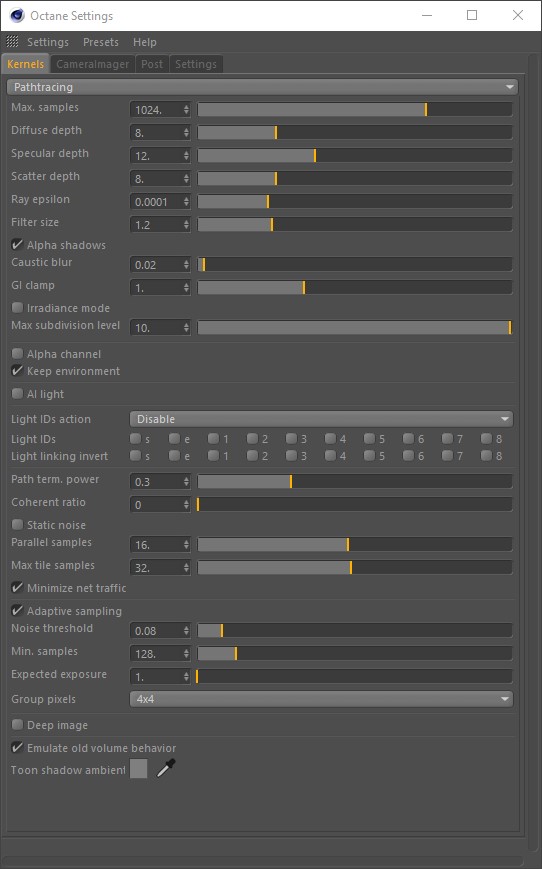

Could it be that the NVLINK adapter is struggling with bandwidth somehow? Could Parallel samples and Max tiles be a factor regarding NVLINK bandwidth?
Here are my IPR settings:

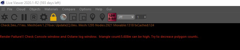

Unfortunately I have encountered the issue again in the latest build. This scene is a very memory intensive so I think my use case is more out of the ordinary.
Here is a screenshot:
It is much more stable in this new build however but still seems to be a problem.
I am unable to see any feedback in the C4D plugin as to whether I am using P2P/NVLink. In SA I can see that there is a P2P bar in blue, presumably to indicate when and how much the scene is in P2P/NVLink.
