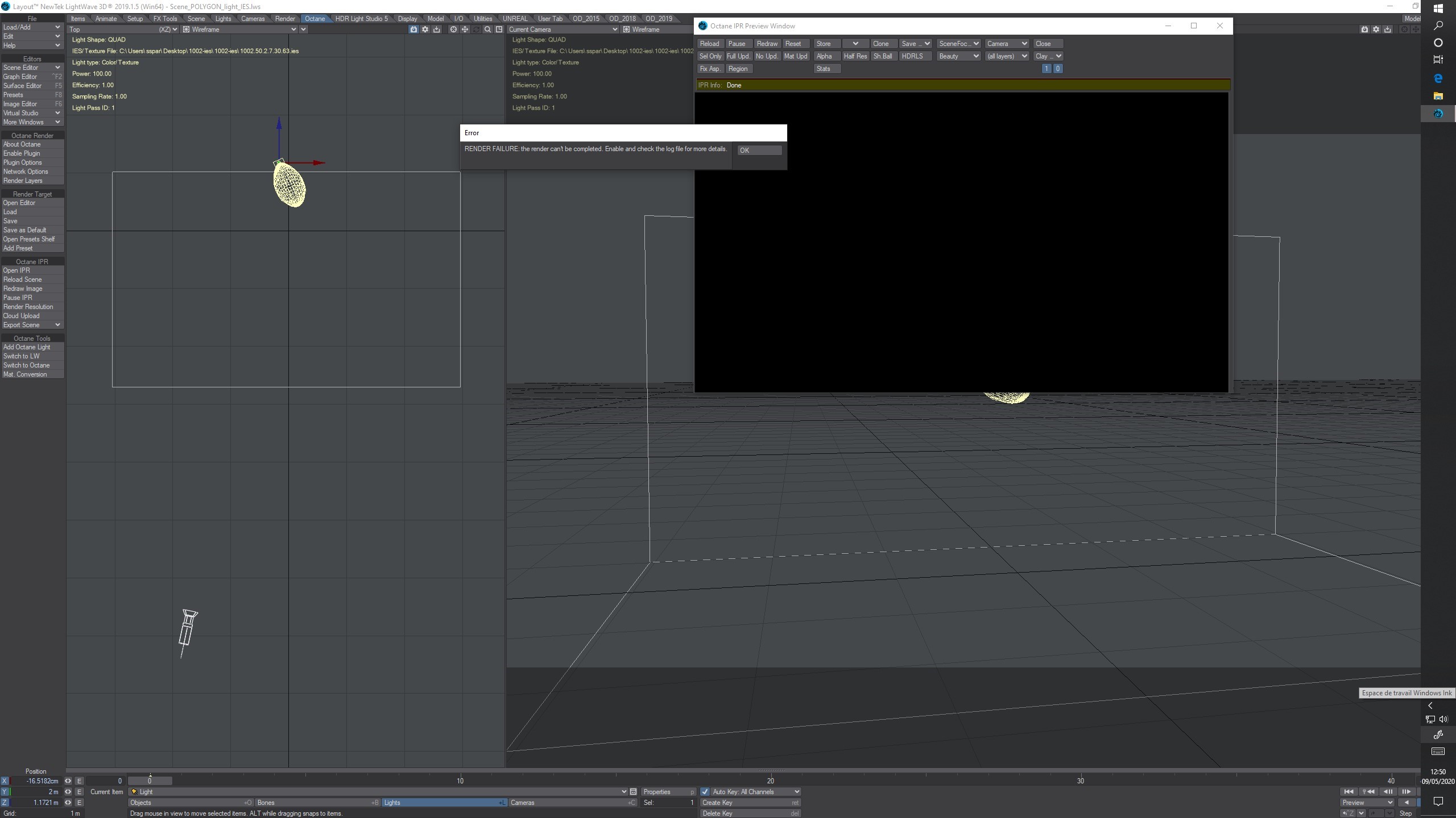

Hi all , did someone noticed this crash, when i moved a octane light with ies attached , ( the IPR is running ) lightwave crash.
if IPR is closed : no crash
if there is no ies files attached to octane light , no crash

Here is what happens on my side (every time).
IPR_IES_Move_Crash.mp4
(7.91 MiB) Downloaded 2715 times

I just tested more and IF i turn of AI light/Update then it's not crashing but my light is not moving in IPR/OGL rendering either, weird :).
This scene is kinda weird, has one Light as Polygon based IES and another as Octane Light IES.
Here is the fresh new LOG file
