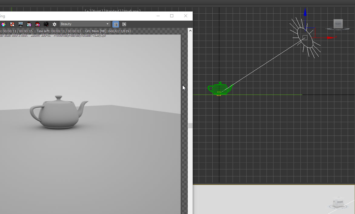

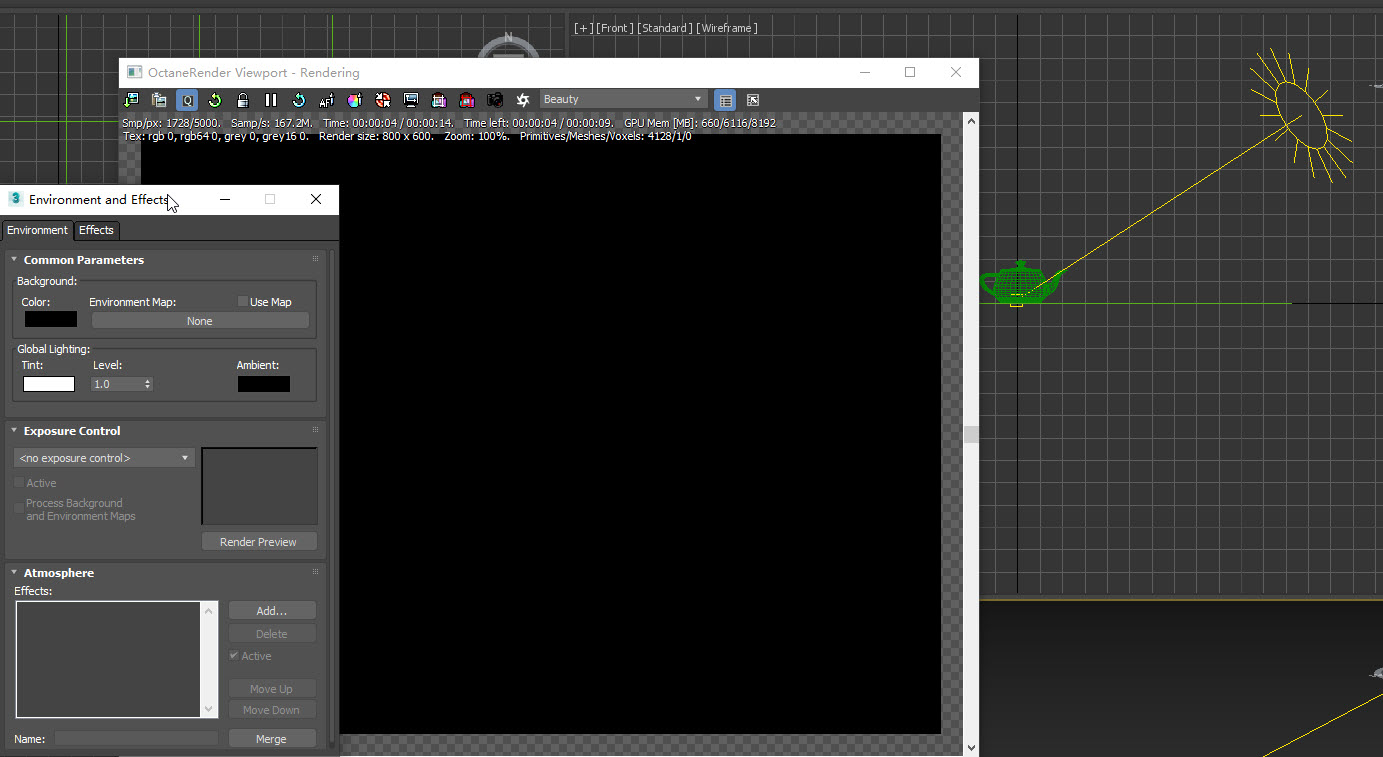

Bug: Drag and drop the daylight into the scene, but it don't work.
Daylight not work

Hi Wensk,wensk wrote:Octane plugin version 4.05-6.28 work correct, the bug only happend in 6.29.
This should be fixed in 6.30, available there: viewtopic.php?f=80&t=74825
