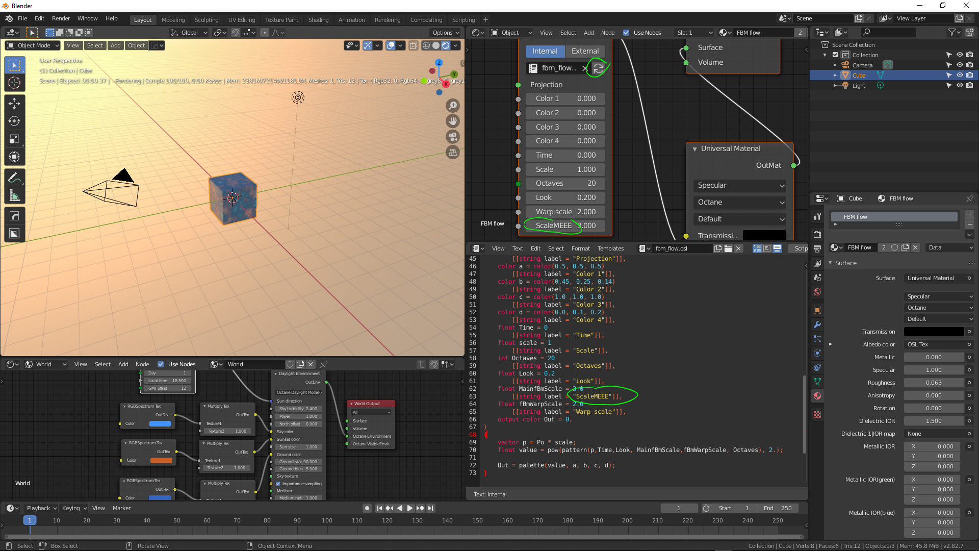

As I am working on some OSL code, and after I have done the initial load, you can no longer reload any new or changed code into the node. I have tried to delete the node and add a new one, but as long as the name doesn't change it will not update. The only way I have found to get around this is to quit and restart Blender, which is a pain.

Unfortunately my system is not setup for a video. But it's very easy to test...
1) load an OSL script into the node (I used an external script).
2) make a change to the script, the easiest to see is if you make a change to an input pin name.
3) reload the script and/or recompile and the node will not change.
It's almost like the code is cached but the cache doesn't get updated?

Thanks, but that is an internal script, which works. My problem is with external scripts, but it's good to have a workaround for now. :)
