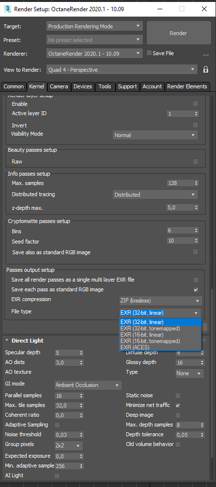

Hi javierluisbravo,
Regards
Paride

Thank you! i don't even have that little arrow to expand that dropdown menu..
it must be because i have a 4k monitor... but with the mousewheel down buttom.. i found it..
I will test it.
I assume this is a transform for the output.. from linear srg => to ACEScg color space.. right? done at the end of the chain.
and it's not a full acescg pipeline... "yet"..
if it is like this.. the good is that it avoids one step of transforming the final renders from linear srgb to linear ACEScg. Something is something :)

Sorry to bother... i changed that to EXR 32 bit ACEScg and rendered like always and it looks the same as the linear srgb version..
Which is the proper workflow for rendering in ACEScg... i can't find anything in the manual online about it... nor even that EXR dropdown menu...
thanks in advanced :)
Javi
