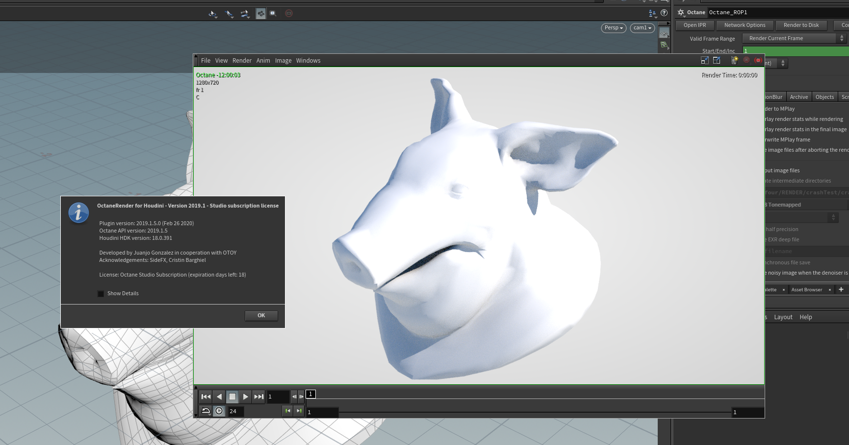

Hmm, nope, here I can't reproduce this problem, as you can see in the attached image. What a weird issue! I'm using CentOS7, not sure if this could be related to a problem with your Linux distro.
And do you say that you don't get any Octane log file?
Thanks,
-Juanjo

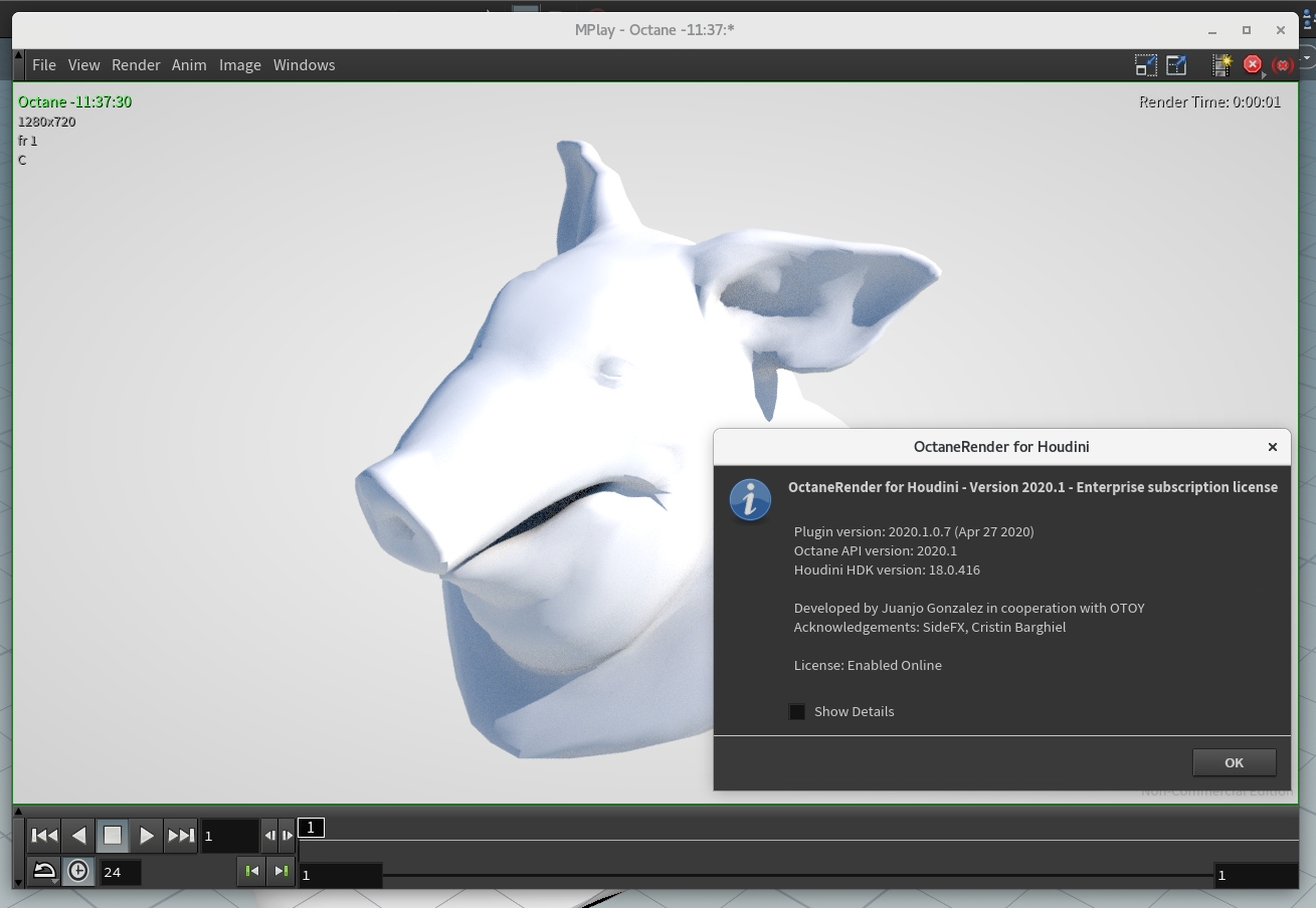

What's even more strange is, with the 2019.1.5 build (for Houdini 18.0.391 on 18.0.416) it works, just tested it.
