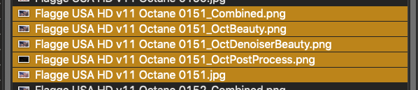

3) And how can I get only one image per frame not 5?

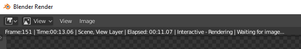

And now Octane is not longer rendering the final image. But the preview is rendering fine. "Waiting for the image …"
I had never so many problems with Octane like now. And I am using Octane sind many years. ;-)
Update:
Single frames are rendering, but animations not.
I moved this issue to here: viewtopic.php?f=32&t=74687

Number 3 is solved. The was some render passes selected in the Viewer Layer Properties.
