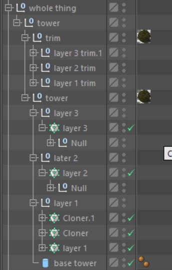

I was shown a method of building structures like castles or whatever using cloners. I can use render instances but that detracts from the look since procedural textures aren't dynamic and repetitions are easily visible. I attached an example of how it's set up. Just a bunch of cloners all grouped in a null so the material applies to everything the same while procedural textures treat it as one massive object.
The guy who showed me this method regularly hit over 5000 shaders using this method but I asked him and he's had no issues with responsiveness, the only difference being that he has two 1080tis. I'm wondering if maybe since I only have one and it's doing both display and rendering if that could be causing the issue.
