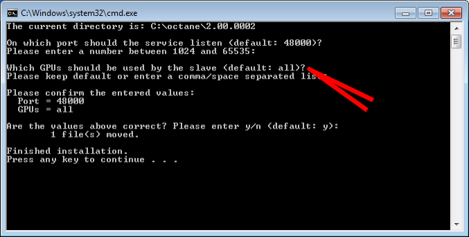

I realized my slave render wasn't using all the video cards, although it was all activated to render during the Octane Slave installation.
The solution was to open 3DS Max and activate all video cards inside 3ds max as well. It's something to check out.

Hi Samsue,
you will set it during the daemon installation.
Regards

i now that :P
but still 2 video cards of 4 were not starting.

Hi samsue,
to set all of your GPUs, you would unistall the daemon then reinstall it.

Posts: 388
Um... weird, next time I'll test if that's what it was. But at first I'd done what you said too.
Anyway,thanks!
