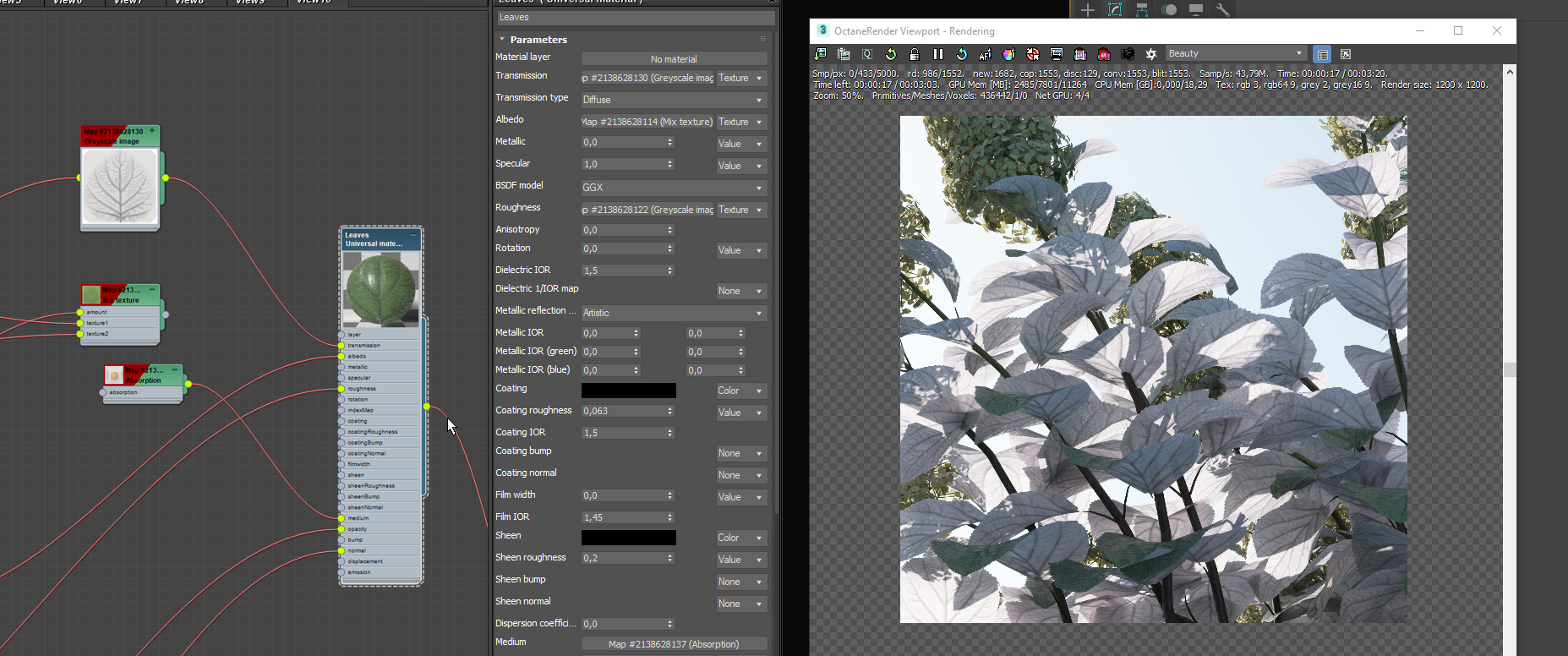

Hey guys,
I'm having trouble creating translucent materials.
I read somewhere, that the tranmission map should be black and white, and use some medium to make the scatter/medium.
But I'm not sure what I'm doing wrong... dont work as plan!
I need some tips. Thanks

Hi samsue,
link the albedo texture node to trasmission.
Regards
Paride

paride4331 wrote:Hi samsue,
Regards
Paride
but why doesn't the medium node have any effect?

the leaves are not volume, they are faces only, the medium will not work for them

jimho wrote:the leaves are not volume, they are faces only, the medium will not work for them
Thanks jimho
