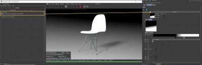

Posts: 10622
In c4doctane 2020.1 you can use a Visible Environment with a c4d Gradient node, with C4D Shader OSL conversion active in Settings:
ciao Beppe
frankmci
Posts: 917
Location: Washington DC
bepeg4d wrote:In c4doctane 2020.1 you can use a Visible Environment with a c4d Gradient node, with C4D Shader OSL conversion active in Settings:
... and in case it's not obvious, use a Shadow Catcher material ground object. Octane Diffuse Material>Common>Shadow Catcher.
