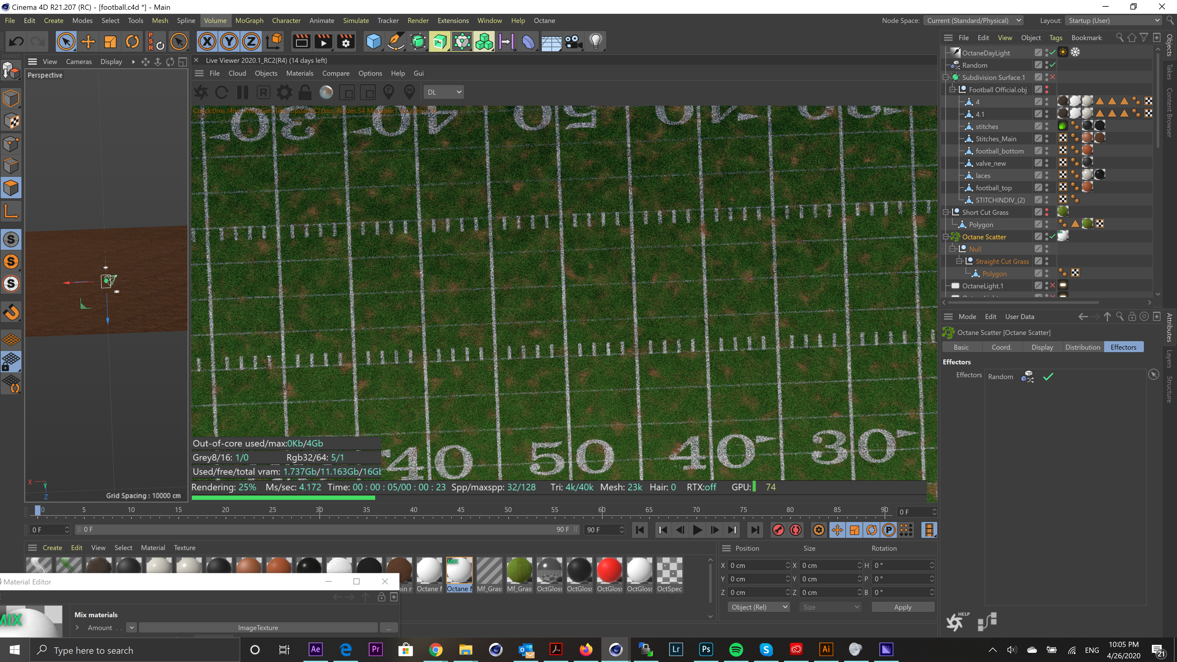

I am having a few issues texturing a scattering object.
I am getting good results, minus some strange horizontal lines coming across my field.
I have tried different methods, such as instancing color, through diffuse, through mixture txture, all with the same strange result - these lines are NOT in the image file.
Any suggestions?

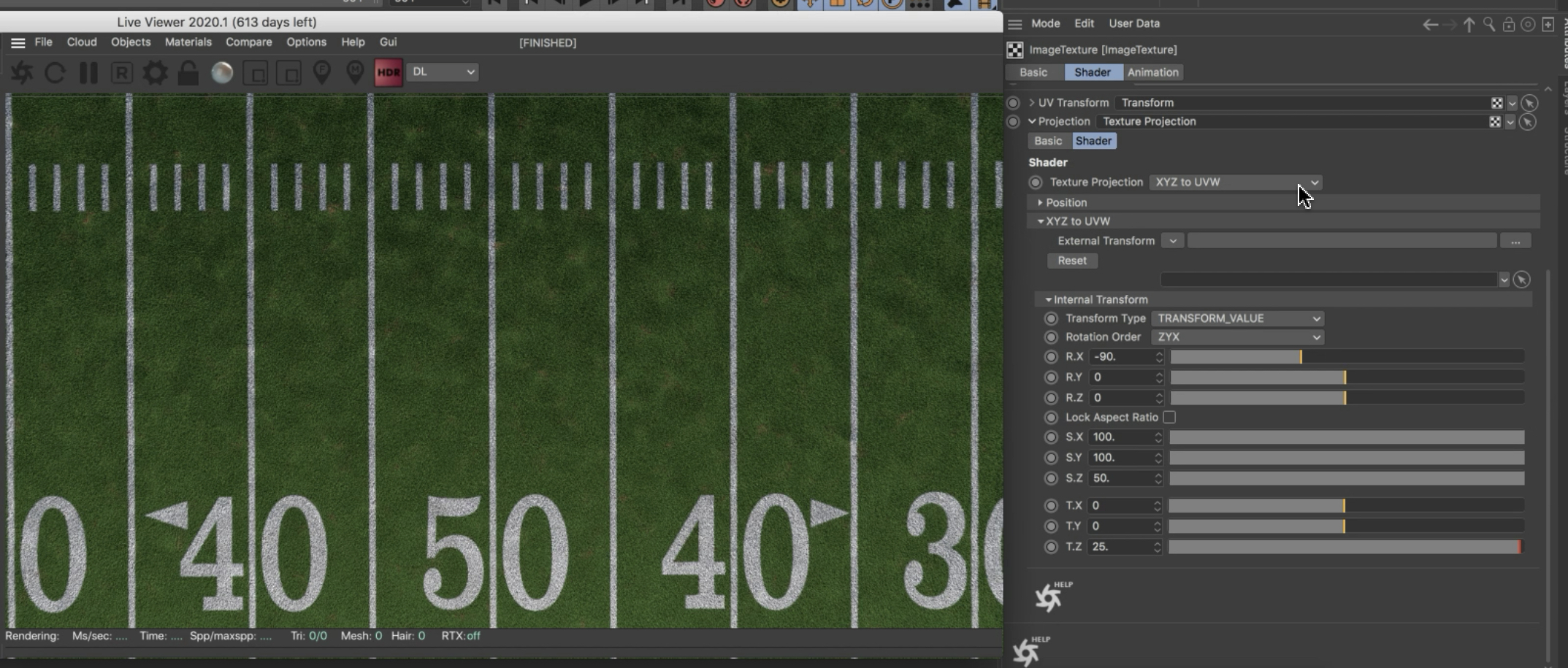

your field is in 3d space, so you need to change the Texture Projection from Box to XYZ to UVW = Planar.
In this way, the texture will be applied only from top projection:
ciao Beppe
