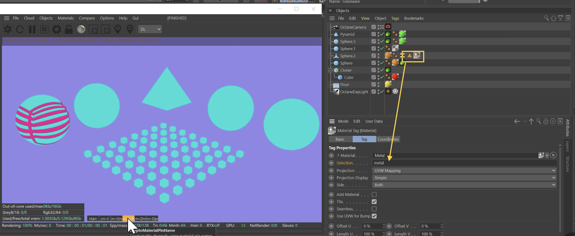

CryptoMaterialPinName pass works with polygon material selections, so you can easily select a specific material of an object with multiple materials assigned:

Thank you, bepeg4u!
Unfortunately it doesn't work in my case with selections. It only works if I put the object in a separate object layer ID. And then only for the entire object.

Posts: 10516
Yes sorry, both CryptoObjectNode and CryptoObjectPinName are working with Object Layer/Octane Object Tag, while CryptoMaterialPinName works with polygon selections.
