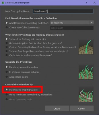

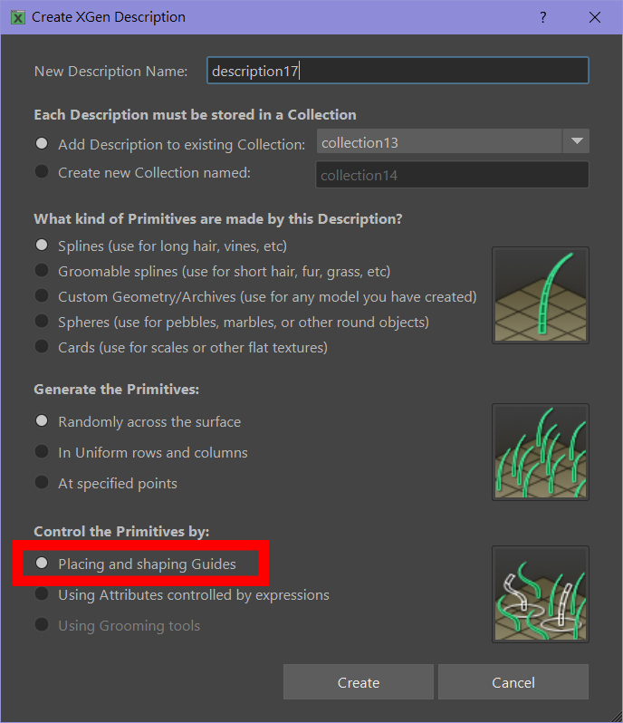

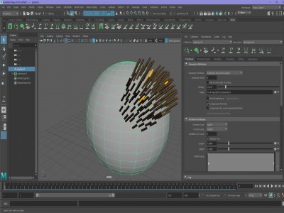

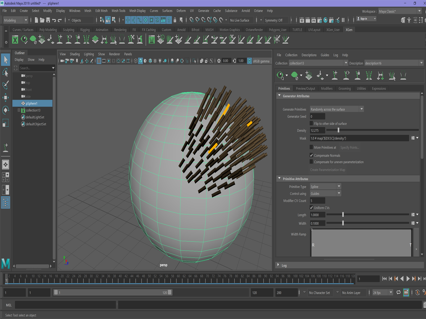

Because I am new to XGEN, I want to ask,
If I use a picture to create, is there a way to come out through OCTANE RENDER?
I have searched for relevant teaching, but I have not found a way
Thanks again for your reply

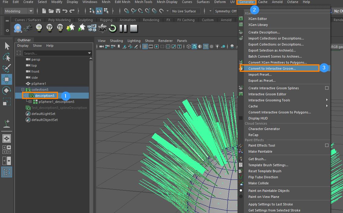

Hiya,
Thanks for attaching the screenshots.
Unfortunately, the Xgen Description are yet to support directly.
Please use Convert to Interactive Groom from the Generate menu as a workaround.
cheers
