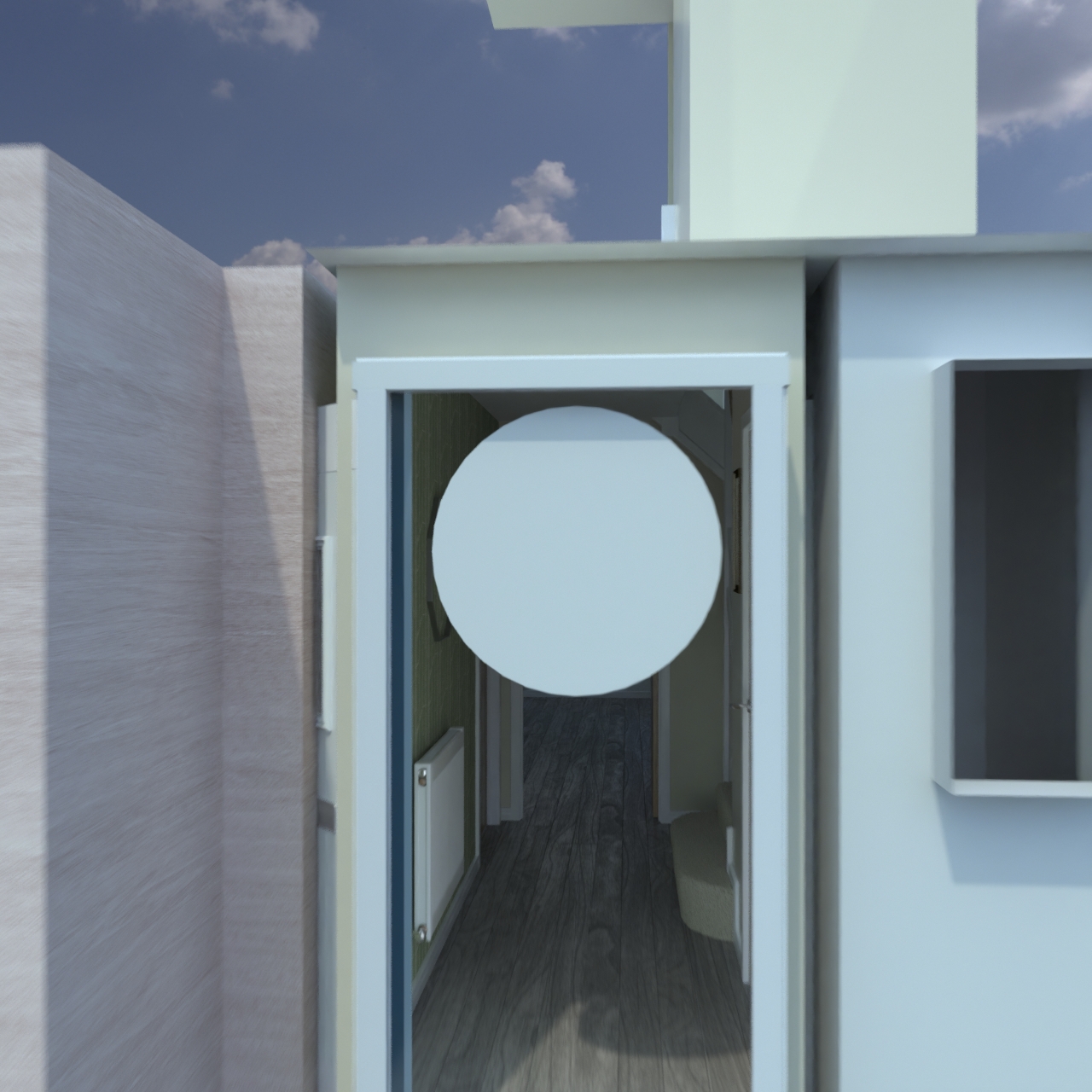

When I use an OSL camera the image looks very squashed in the vertical. I get the feeling the camera is trying to make a square image but my rendering resolution is 1280x720.
In the attached images the disk in the doorway is/should be circular.
Any ide how to make the render scale correctly?

Yup. Couldn't see anything about why it was rendering a square aspect ratio though.

However, I cut and pasted this from the Octane how to code OSL camera shader documentation and made an OSL file.
Hoped it would make the OSL camera bahave like a standard camera and somehow it seems to work. Got lucky for once.

So the OSL standard camera osl will render at the right aspect ratio but doesn't appear to have any DOF target focus options.
So can't really think of a reason to use the OSL cameras. Plus, they're no quicker.
