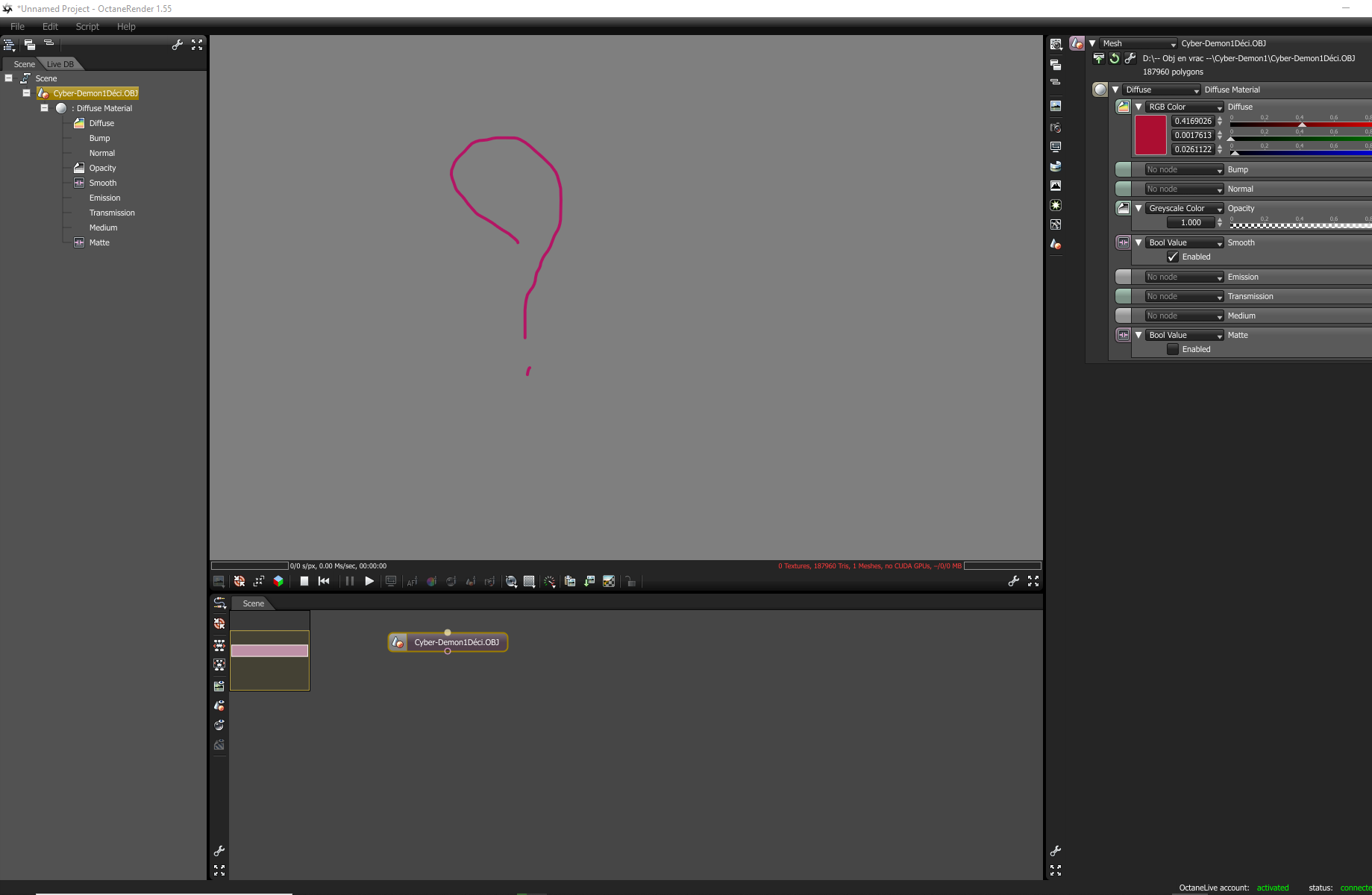

I just reinstalled my old Octane 1.55 "standalone", octane imports the mesh, it's ok, but there is nothing in the viewport. can someone help me understand the problem please? :)

You'll need to at least add a RenderTarget node and plug your geometry into it to see anything in your viewport.

frankmci wrote:You'll need to at least add a RenderTarget node and plug your geometry into it to see anything in your viewport.
No nothing is happening, I think there is another problem :cry: :shock:

Starting with an empty project file and without any established camera, it defaults camera position of 0,0.5,1, so you probably need to pull back/zoom out quite a bit to see your geometry.

Yes, that's what I did before. But there, I can not move anything, the cursor is blocked on the hand (pan). Left click nothing, middle click nothing, right click nothing. The rest seem to be working fine :roll:

1.55 is pretty old, it might not support the newer drivers. I would run it in a command terminal and see if there are any error messages. You might have to downgrade your video driver to a version that was current around the same time that 1.55 was out.

Hi ,
Ok there seems to be an error with cuda. This is what Grimm predicted. I can't, and don't want to change drivers just for that, so many I'll end there.
Thanks for your help .
take care of yourself .
Started logging on 23.04.20 12:27:49
OctaneRender version 1.55 (1550000)
CUDA device 0: Failed to find a CUDA binary matching compute model 7.5
