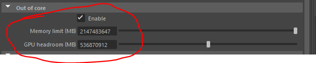

Out-of-core (mesh) still doesn't work for me.
As soon as the memory of the video card is full, I again get the message "out-of-core memory limit exceeded" and the rendering stops (or does not start at all).
Despite the fact that a large OOC limit is set (24 of 32 GB) and I have free RAM. It looks like the OOC just isn't working properly.
In addition, if I export the same scene to Standalone, then it works perfectly inside Standalone and uses OOC (about 3 of 24 GB). The same thing happens if I render a scene in Cinema 4D
Thus, it turns out that OOC does not work only in Maya.
And this happens not only with this version, but with all versions starting from v4.
I think that if it were a core error, it would manifest itself in both Cinema 4D and Standalone. This is true?
Win 10 x64 (1909) | Geforce 2x GTX 1080ti, 1x RTX 2080ti | i7 4790k | 32GB
JimStar
Posts: 3852
Lord-Kvento
OK I see what's the problem. In my tests this worked OK in Maya, but the labels of the out-of-core parameters settings are "Memory limit (MB)" and "GPU headroom (MB)", while the values in these fields are treated as bytes.
I'll change it in next version to be treated as megabytes, same as the labels state. As a quick fix for previous versions - just enter these values as bytes.
Sorry for that.

JimStar wrote: As a quick fix for previous versions - just enter these values as bytes.
JimStar
Unfortunately, I cannot enter a value greater than 2147483647 bytes = 2048 megabytes (2 GB). And for me to work, the scene needs at least 3 GB.
So unfortunately this method does not work for me.
For work, I will use OctaneRender for Maya v4.05 (as the main one) and OctaneRender for Maya 2020 (for an alternative project).
Could you release in the near future a quick fix at least for v4.05?
And for v2020 I will wait for the next update.
