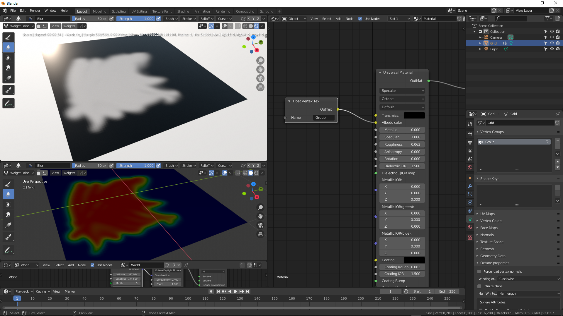

The Float Vertex node doesn't seem to be working for me (in Blender or SA). I must be doing something wrong. However, the Color Vertex node acts as a mask perfectly, especially if I simply create my vertex color in B&W.

linograndiotoy
Posts: 1508
Works here:
pegot
Posts: 954
Joined: Mon Nov 07, 2011 3:44 am
That looks like a weight map. I used the Vertex paint. I will try it again using weight painting this time.

pegot
Posts: 954
OK Yes it works with the Weight Painting. So Float Vertex node works with Weight Painting and Vertex Group. While Color Vertex node works with Vertex Painting and Color Group.

linograndiotoy
Posts: 1508
pegot wrote:OK Yes it works with the Weight Painting. So Float Vertex node works with Weight Painting and Vertex Group. While Color Vertex node works with Vertex Painting and Color Group.
Thanks! I now fully understand the differences.
As you mentioned, we have 2 nodes, Float Vertex and Color Vertex. The first is dedicated to Vertex Groups, the second to Vertex Color Groups.
There are different ways to define Float Vertex and Color Vertex Groups in Blender. Weight Painting is just one of them.
