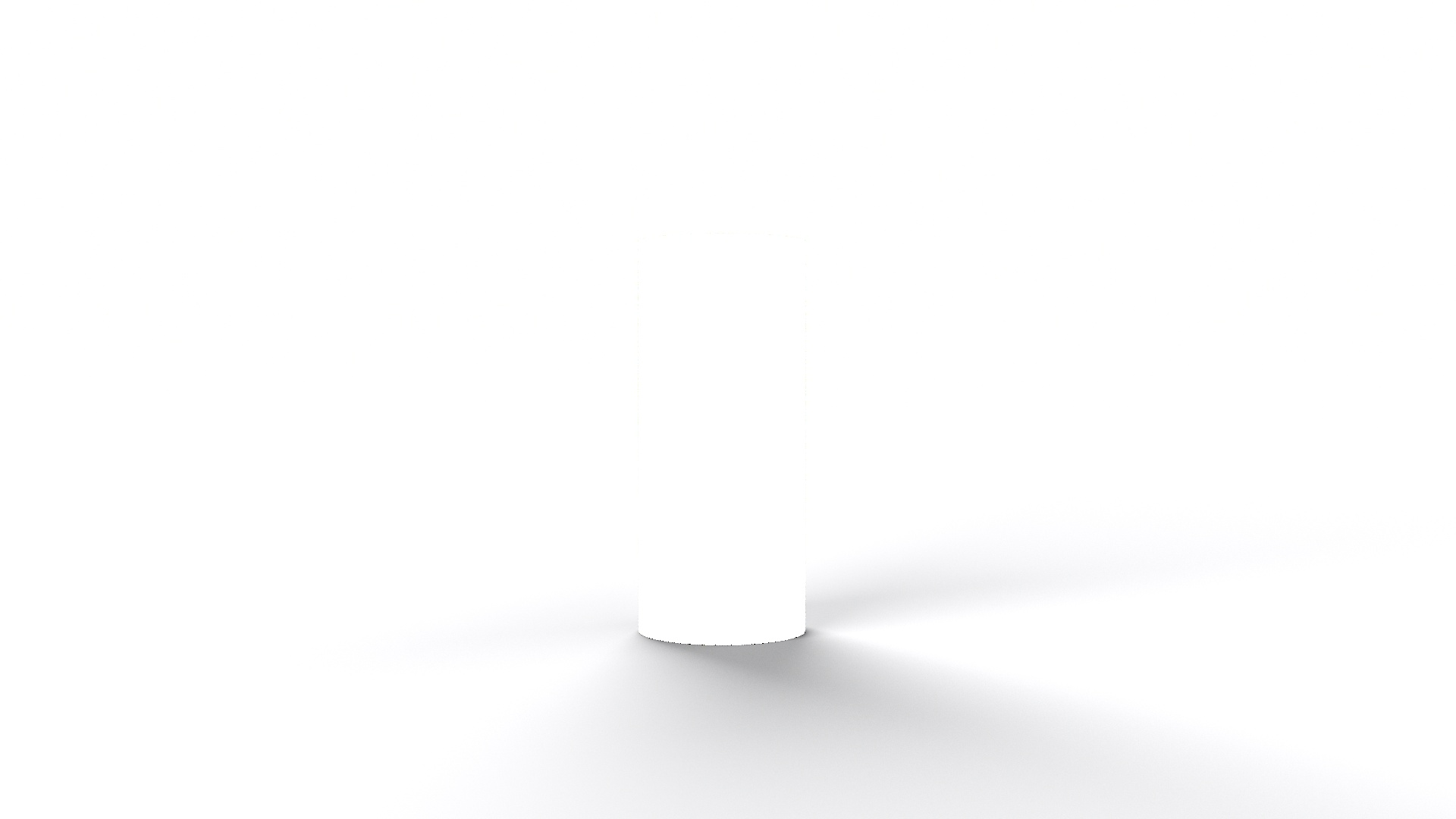

This is what the shadow pass looks like - there's an entire extra section of shadow in front of the cylinder that shouldn't be there.

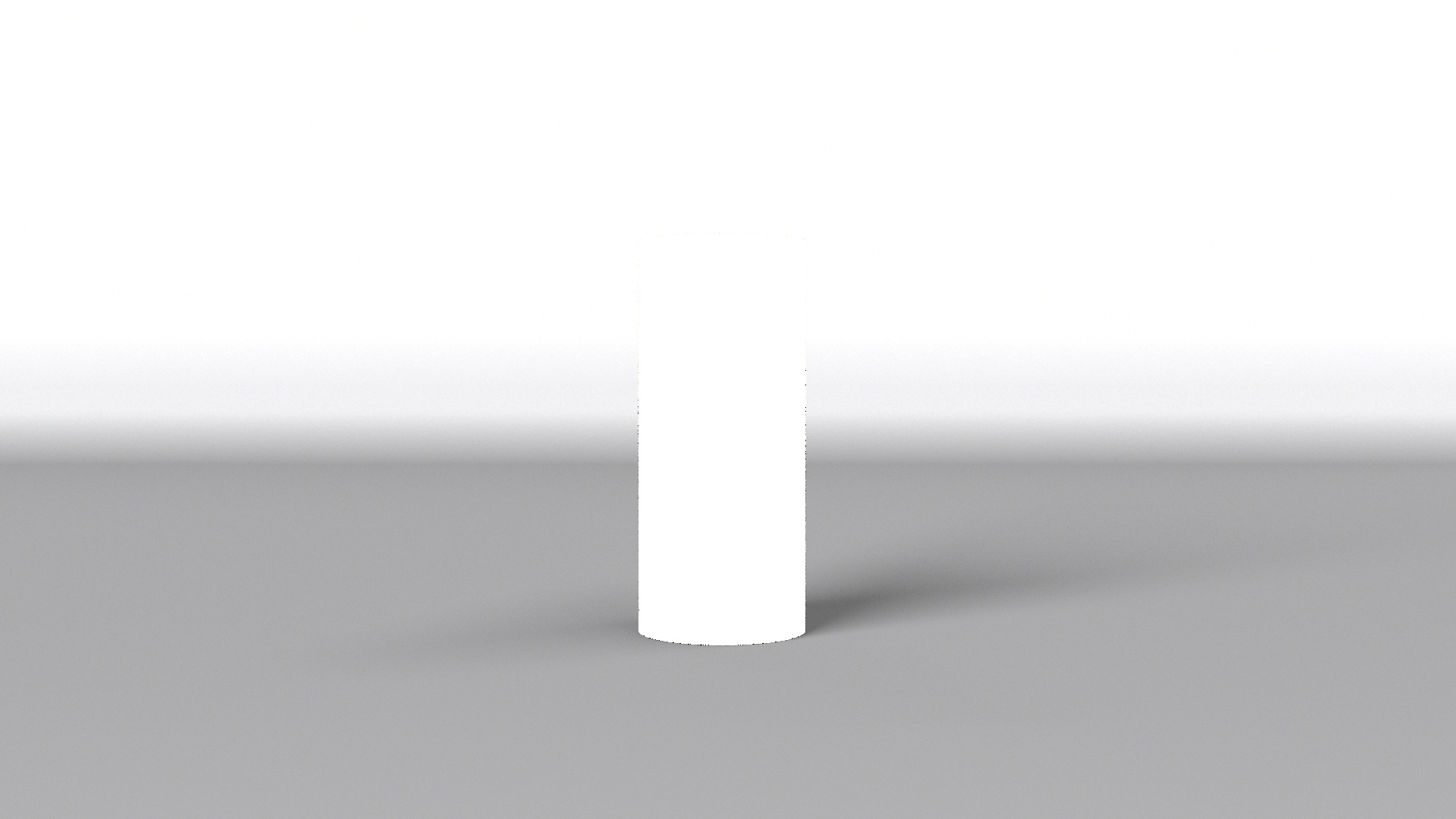

If i disable "Alpha Shadow", this is what I get:
I get the correct shadow below the cylinder, but also get the entire environment shadow for the background - this is not what I want. I only want the shadow that layer 1 (the cylinder) is throwing on to layer 2 (the background!)

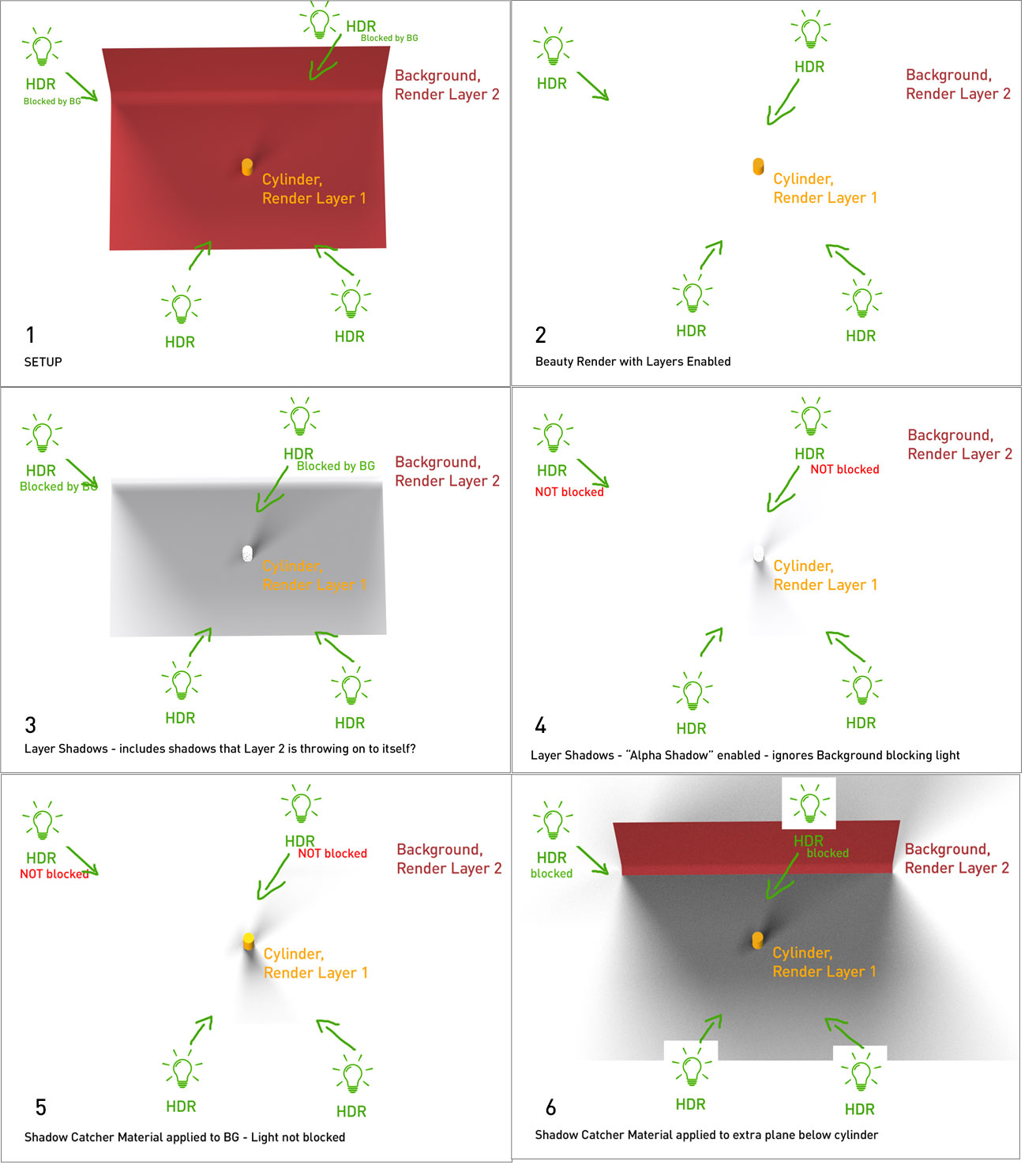

Hi Paride, thank you but that doesn't work either. I've done a lot of testing over the past days and I cannot find a way to set this up to just get the layer shadows I need. I've compiled a big image for info with everything I've tried.paride4331 wrote:Hi designandcode,
I would not use shadow pass compositing in your case, I would recommend you to use and shadow catcher and render layer on the fly.
https://docs.otoy.com/StandaloneH_STA/S ... Passes.htm
Regards
Paride
1) Scene setup, with a pretty normal environment for product rendering scenes - there is a 360 degree HDR lighting the scene, and some of the light is being blocked by the background plane
2) Beauty Render -behaves as expected with light from behind plane blocked
3) Layer Shadows - this seems wrong? I have it set to Layer 1, so I'd expect to see only the shadows that Layer 1 (Cylinder) are throwing on to Layer 2 (Plane), instead I also get the shadows that Layer 2 (Plane) throws on to itself?
4) Layer Shadows with Alpha Shadow enabled - ignores the background plane blocking the light behind the cylinder
5) With Shadow Catcher Material applied to Background Plane - ignores light being blocked
6) With Shadow Catcher Material applied to extra plane below cylinder - completely unusable
Is this how it is supposed to work? It seems insane to me that I cannot get a simple shadow pass from an object with correct lighting information just because some of the light is being blocked?
Is there any way to get what I need here, or is it just impossible?
