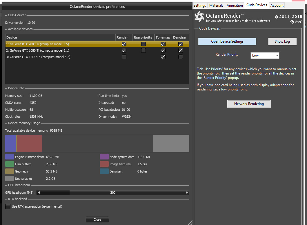

However, this one is a puzzler for me.. I currently run three video cards on my X99 system; 2080Ti, 1080Ti and a TitanX (one of the original first ones out)...
With the the previous version, all three cards were used and greatly reduced rendering times... (the 2080Ti is used for display monitor)
But with this version, I see that only the Ti cards are being used...?
When I look at the Cuda devices page info (which now always needs to be expanded to see the devices). It shows all three cards available but only that the Ti cards are being used.. I cannot select the TitanX card at all.. it won't click on... ?
Though MSI AfterBurner fan controller (shows card temps) indicate that the Ti cards are running hot, the TitanX is running warmer than idle, so some use of it is being made, but not for full rendering as it was before... Now my render times have slowed down enough to be an issue for my work flow..

As for this new version of Octane, are my settings correct in the device panel, did I miss something about the update info not permitting the TitanX to be used again?

Thanks Paul, I've downloaded / installed the Stand Alone version and it also will not permit the selection of the TitanX video card.

Finally heard back from OTOY...
"It appears that you may be experiencing performance issues related to new features specific to OctaneRender 2020. Particularly when compared to OctaneRender 4, there are many new, resource intensive features that will place a higher overhead on GPUs. These new features are optimized for Pascal, and very recent additions are optimized for RTX support.
It is worth noting, that OctaneRender 2020 is still in a test state at the moment (a Stable Release is due very soon), so further optimizations are still pending."
