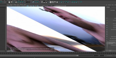

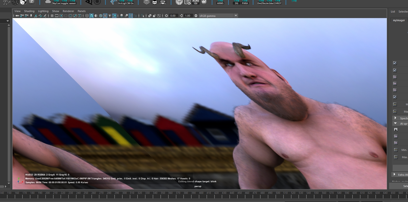

2x2 Works but this is what happens when I switch to 4x4.
This is version 2020.1 RC3 17.14-beta
Windows 10

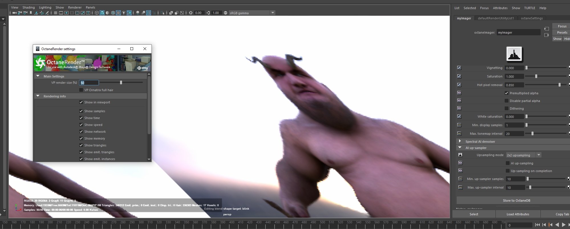

Here I am on 2x2 up-sampling, then reducing scaling in viewport options.

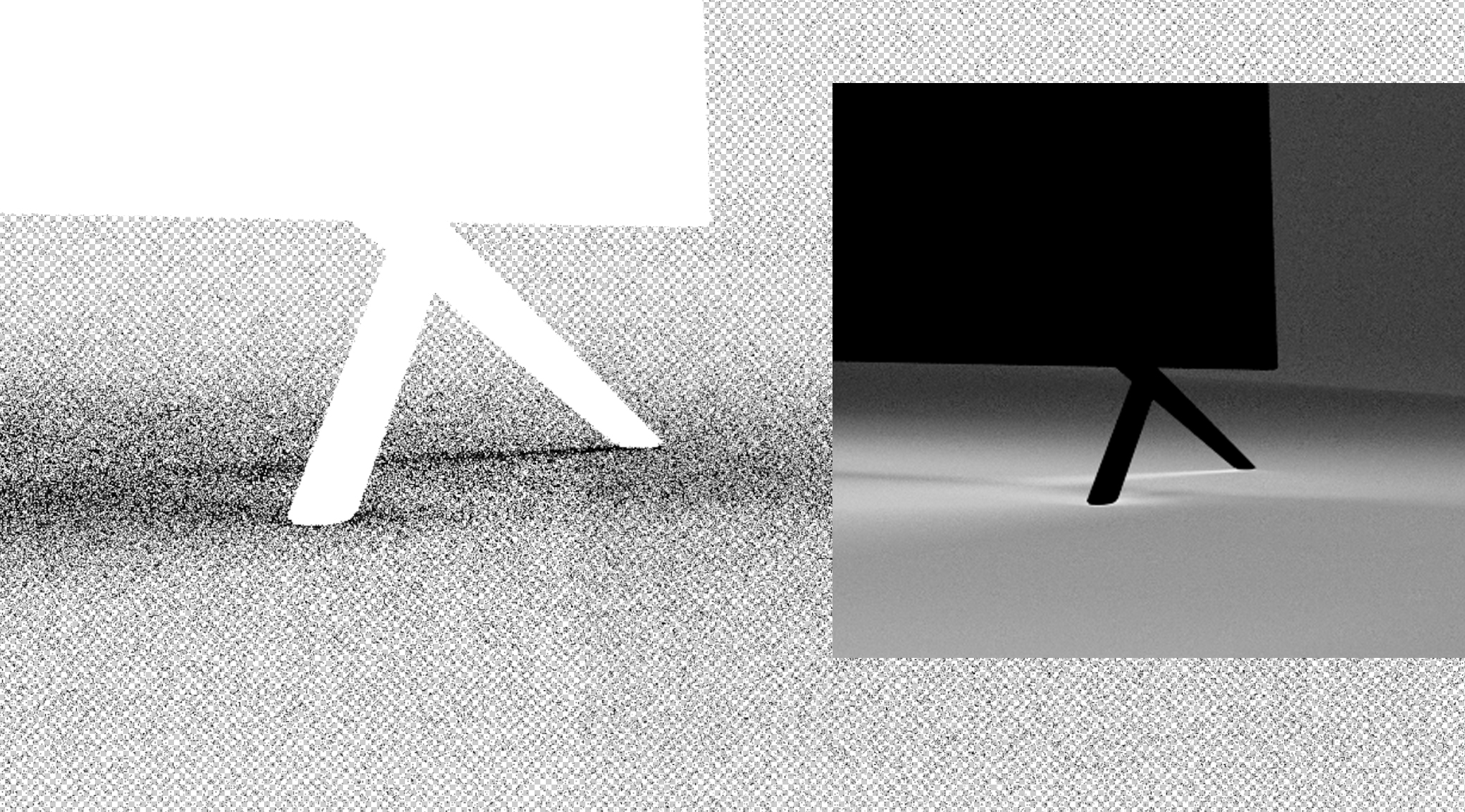

I ran into a possible problem.
I am rendering 2 layers, Layer 1 - Object, Layer 2-Backdrop with shadow catcher material.
I am also doing batch render layers. I tried numerous times and in the EXR output Layer 2 is completely messed up,
like it did not finish more than 10 samples and anyway it got saved. Take a look, left- rendered exr, right- IPR of the layer 2 in maya:

I've just found a very old ticket exactly about this: this is a very old Octane SDK bug, which I already reported last year to the engine team. They told me it's easy to fix, but as I can see it's still there...
Can't be properly fixed on the plugin level. Moreover, this bug may be one of the reasons of the GPU crashes that are happening sometimes when using upsampling.
Just don't use the upsampling when viewport-rendering, and for the other rendering modes use the output image size which is a multiplier of 4.
