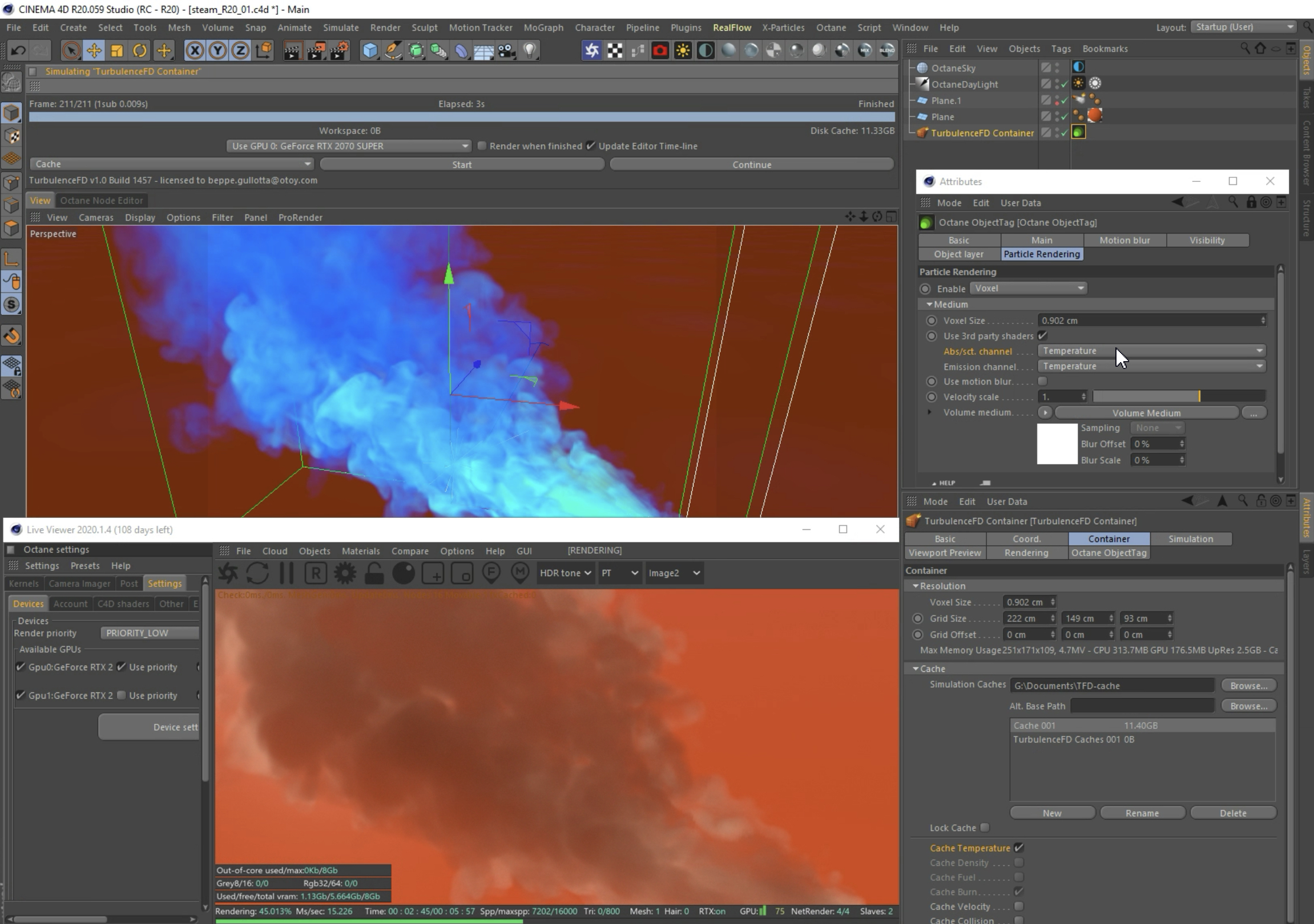

Octane 2020.1.4 Cannot render TurbulenceFD? What is wrong with me?
