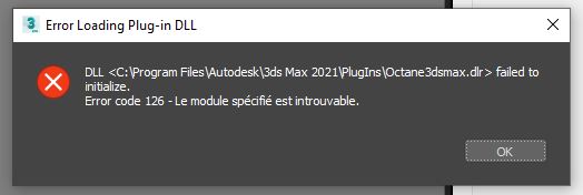

But I get an error (see pict )

Yes same here. Please tell us how to get around this MANUALLY now so we can proceed with it. And also exactly WHEN it will be available officially for 2021. I have a client using it now that wants to me upgrade.

Ok which version can we use ? I tried with 2019 1.5 8.19..... too old perhaps... ? :lol:

Hi HHbomb,
yeah that's it, this trick works only with Octane v2020, no v2019.
Regards
Paride
HHbomb
Posts: 1434
Yeeees, it works with last 2020 version ! Thanks
