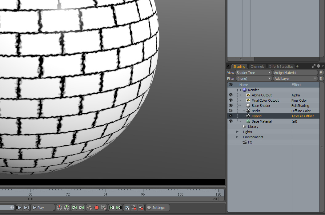

The node I'm looking for is very powerful because you can "Offset" or "Distort", if you prefer, one textures with another one "pixel by pixel". If it doesn't exist I hope they will do in the future, or maybe some genius ... could do an OSL?
Here the node in MODO.
Ciao,
Roy
