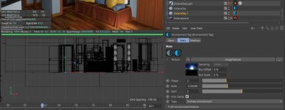

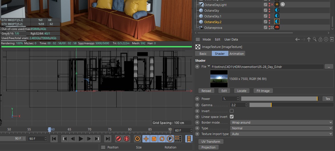

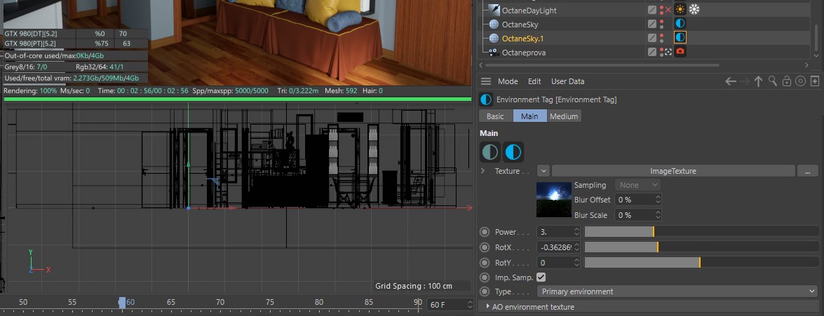

Hi Beppe,
I did some tests.
I created two Sky: in the first I inserted the 8bit jpg image in the Visible Environment nod and in the second sky I inserted the hdr image scaled in the Primary Environment node. Then I did the test using the original 32-bit HDRI.
Comparing the values captured by the two different renderings, however, I know that the 2-sky method consumes more VRAM than the original HDR method.
Did I do something wrong?
I did some tests.

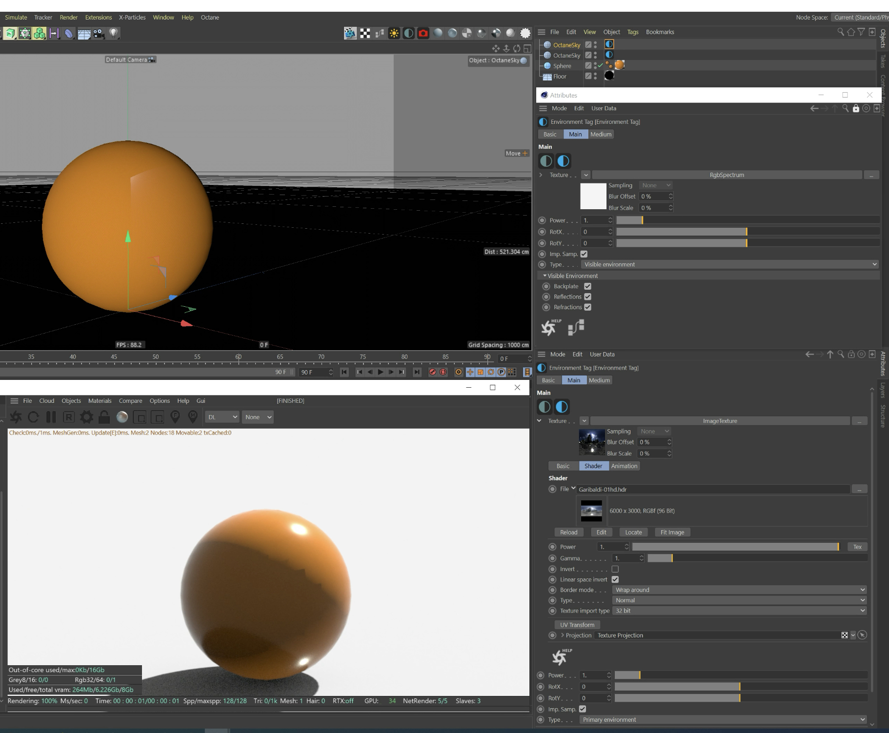

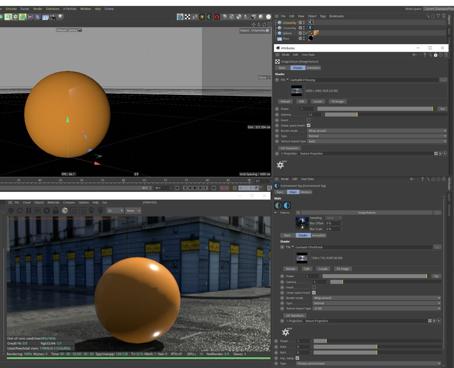

from your screenshots, there is 1GB of memory difference, ~200MB of VRAM, and ~850 of Out-of-core, but I cannot understand which one does have the visible environment, and which one does not
Anyway sorry, I was not accurate, you need to decrease the original HDRI resolution by 4x to see a difference.
Please, have a look at the following screenshots.
HDR 6k + white Visible Environment = 264MB: HDR 1.5k + 6k 8bit Visible Environment = 178MB: ciao Beppe
