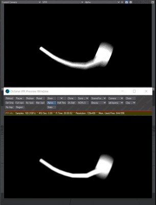

I get these extreme motion blur on objects parented to a bone string. Can anyone tell me how to do this correctly within Octane?

I'm checking your scene and the motion blur seems right to me. As you can see in the attached image, the Octane motion blur matches the LightWave native renderer motion blur, so I can't see any problem with it.

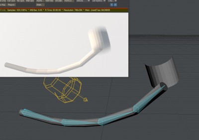

The motion blur in this sene is ok in F9 render, but IPR isn't right. Look the difference between F9 and IPR.

Be aware that the IPR can't render the deformations and instances motion blur, so if there is any difference between the IPR and F9 renderings, usually the problem comes from this limitation.
