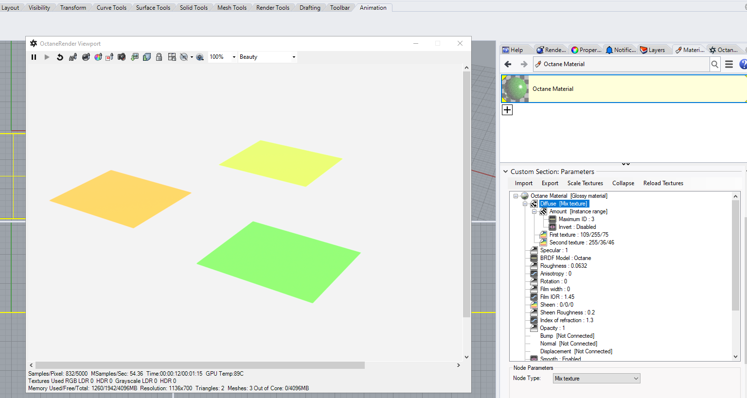

I'm using blocks instances with Random textures colour inside the material. So I can see different colours for each block instance. Now I would like to know if there is some way to transform randomly the position of the texture too. Or some other way to make others change between the instances appearance from a single material applied to all.
Thanks, Roy
face_off
Posts: 15809
Location: Adelaide, Australia
Hi Roy
A block instance will assign an "Instance Id" for each instance of the block. So you can use the Instance Range node to set the color for each instance.
Paul

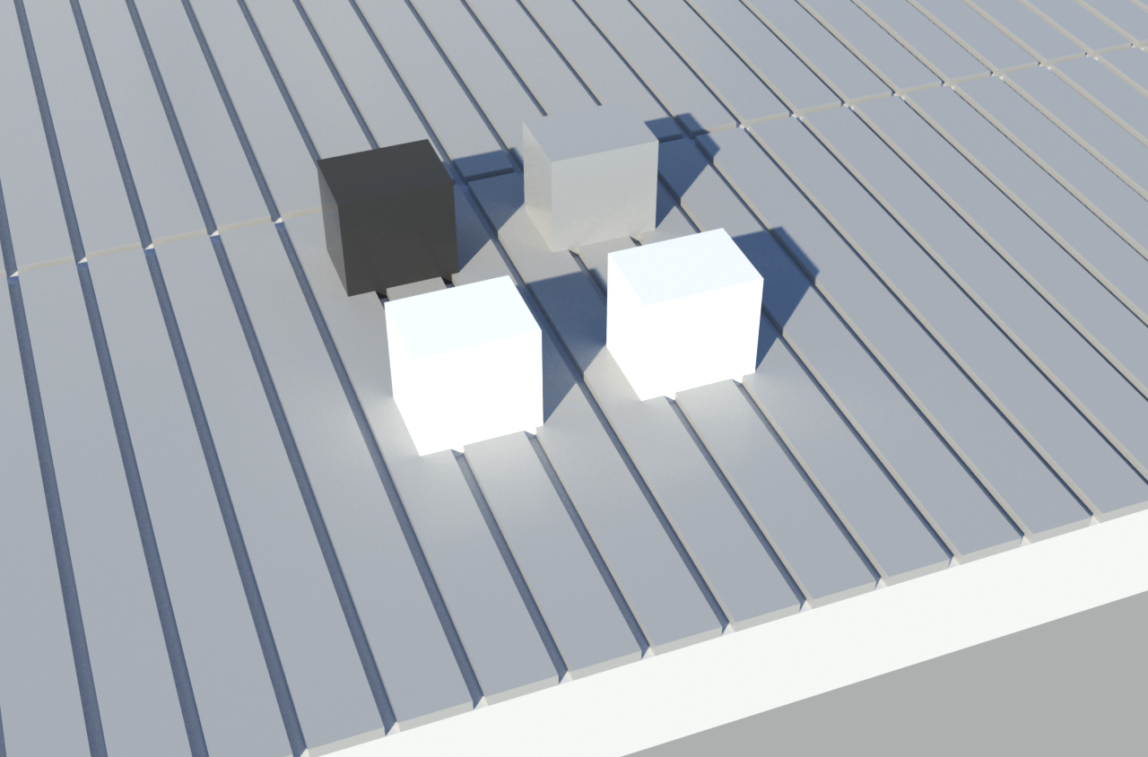

In this image, all the objects have the same material (with random colour texture applied). The cubes are instances so they show correctly the different colours.
The planks are not blocks, only some copy of the same object, so they are different Polysurfaces in Rhino. There is some way to apply to that planks too one single material with variations as the instances doing? I mean, each single planks have their ID, why they don't show the random colours?
Roy

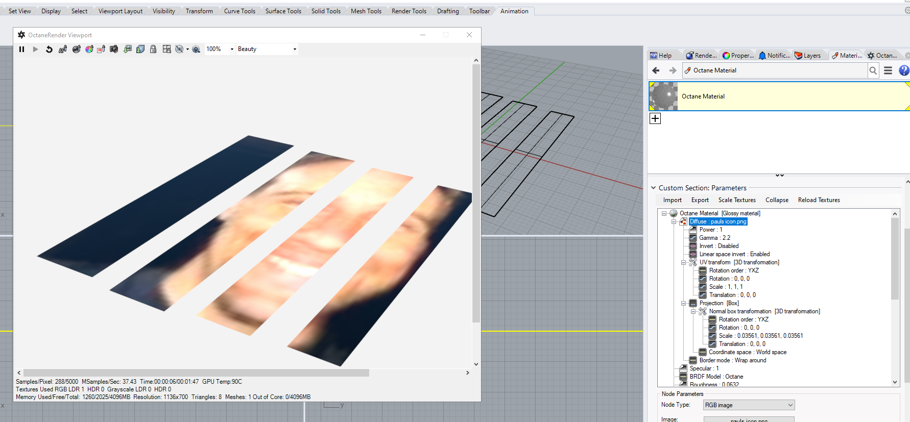

Hi Roy - as the planks are not instances, they will not have an ID - so therefore the random color texture will not work. You could randomize them with a texturemap that is applied in world space with a Projection mapping such as Box (in practice you would probably use this as an input to a Mix Texture to mix things up).
