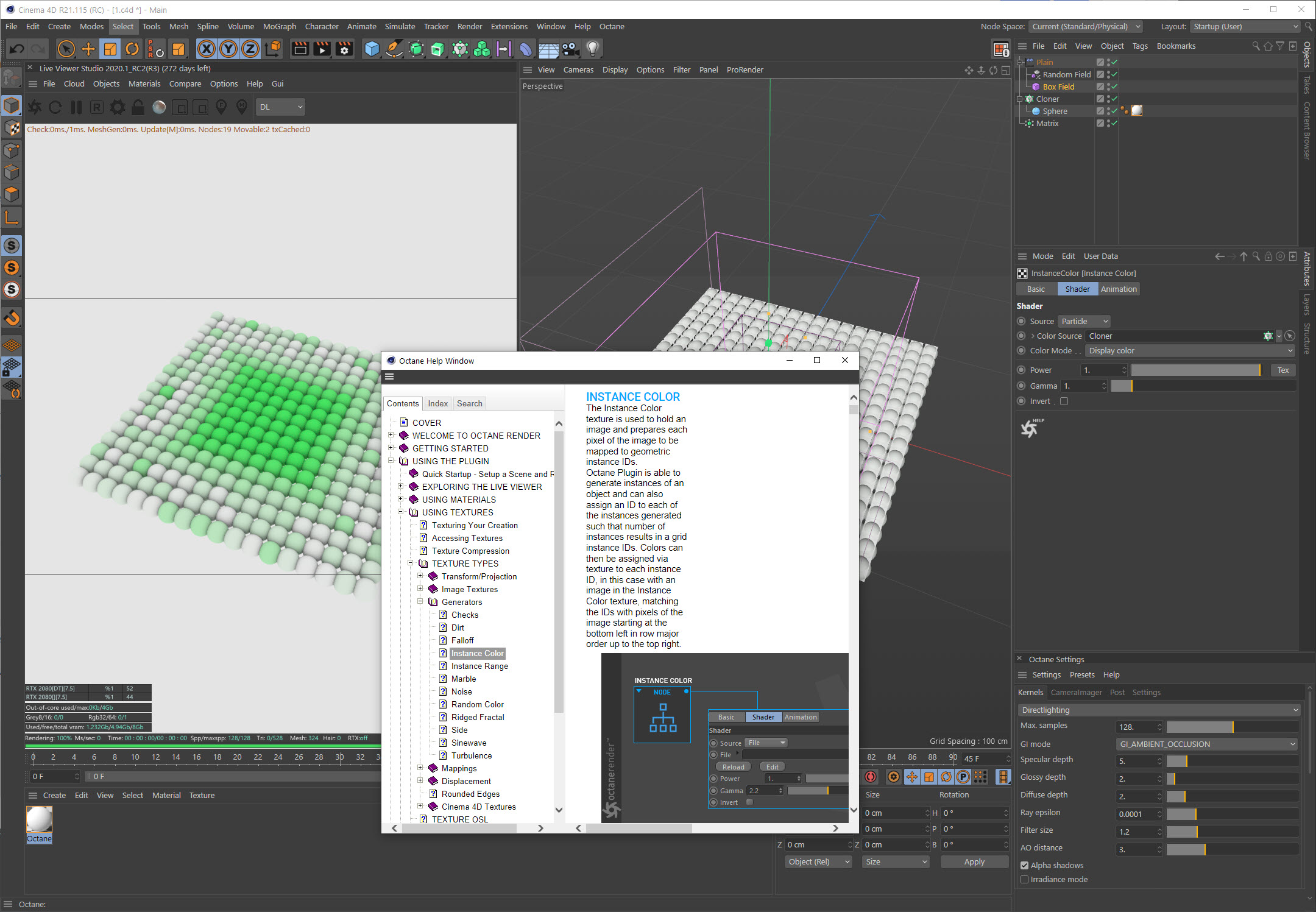

If you're using cloner then you can use InstanceColor texture. Check the c4d manual.

aoktar wrote:If you're using cloner then you can use InstanceColor texture. Check the c4d manual.
Could not find this on the manual, I found 'instance,' nothing on instance color texture.
Posts: 16067
Location: Türkiye
Really? Create it and press help icon in this texture.

I was able to find it, but this does not really solve the problem. As I cannot use color remap or fields.

noaxyz wrote:I was able to find it, but this does not really solve the problem. As I cannot use color remap or fields.
Here is
