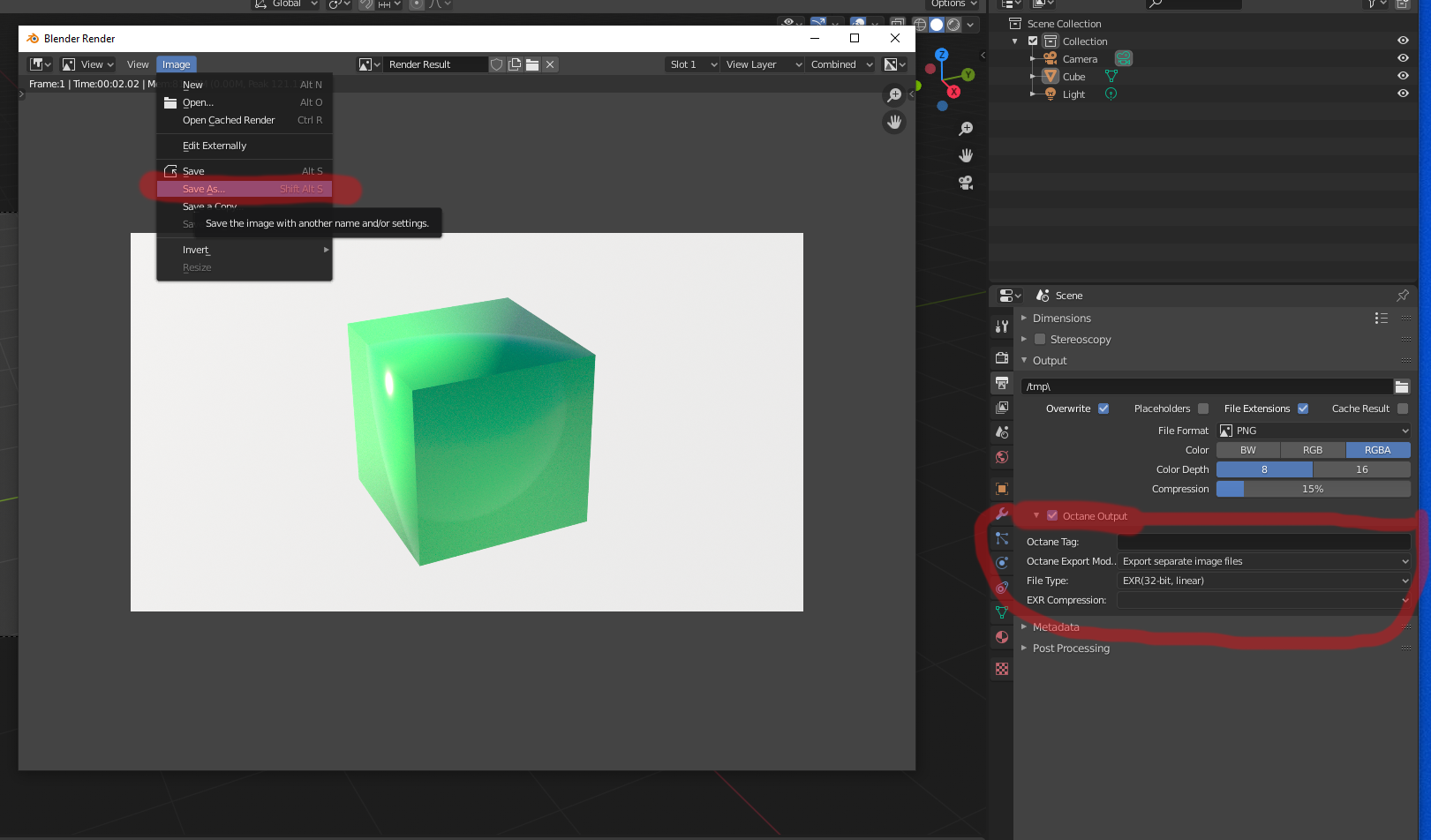

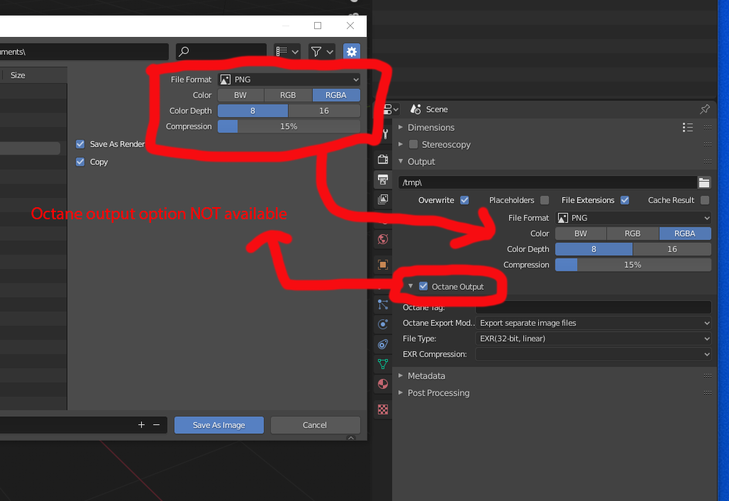

2) See attached screen shots for clarification of what I believe J.C is referring to. There is only the option to save as Blender's defualt output option, regardless of whether or not one has checked the Octane output in Output properties tab. This also goes to what I was saying about the Compositor and File output nodes - there too only the Blender default outputs are available; one can not gain access to Octane output formats. See my recently posted User request:
viewtopic.php?f=115&t=74547

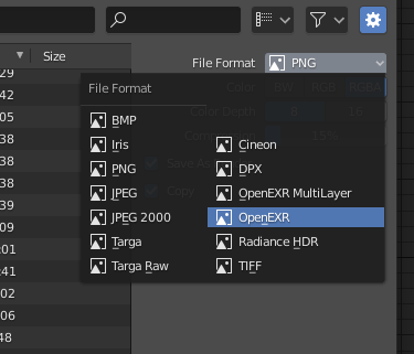

You can select OpenEXR (single or multi) from the File Format option.2. Not possible. There is no such option in save file dialog when saving single image from final render window. I'm I missing something?

Yes, but only by using Blender's default output. Is there anyway to also get access to Octane's exr output in the save as export?linograndiotoy wrote:You can select OpenEXR (single or multi) from the File Format option.2. Not possible. There is no such option in save file dialog when saving single image from final render window. I'm I missing something?
