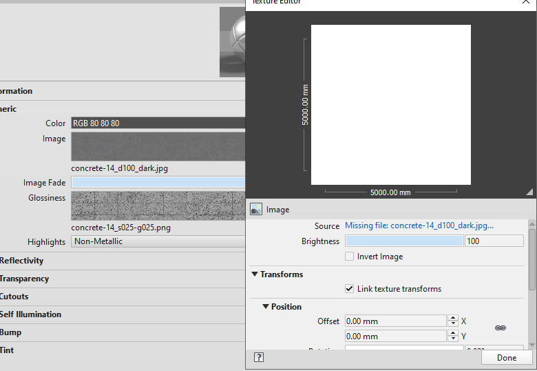

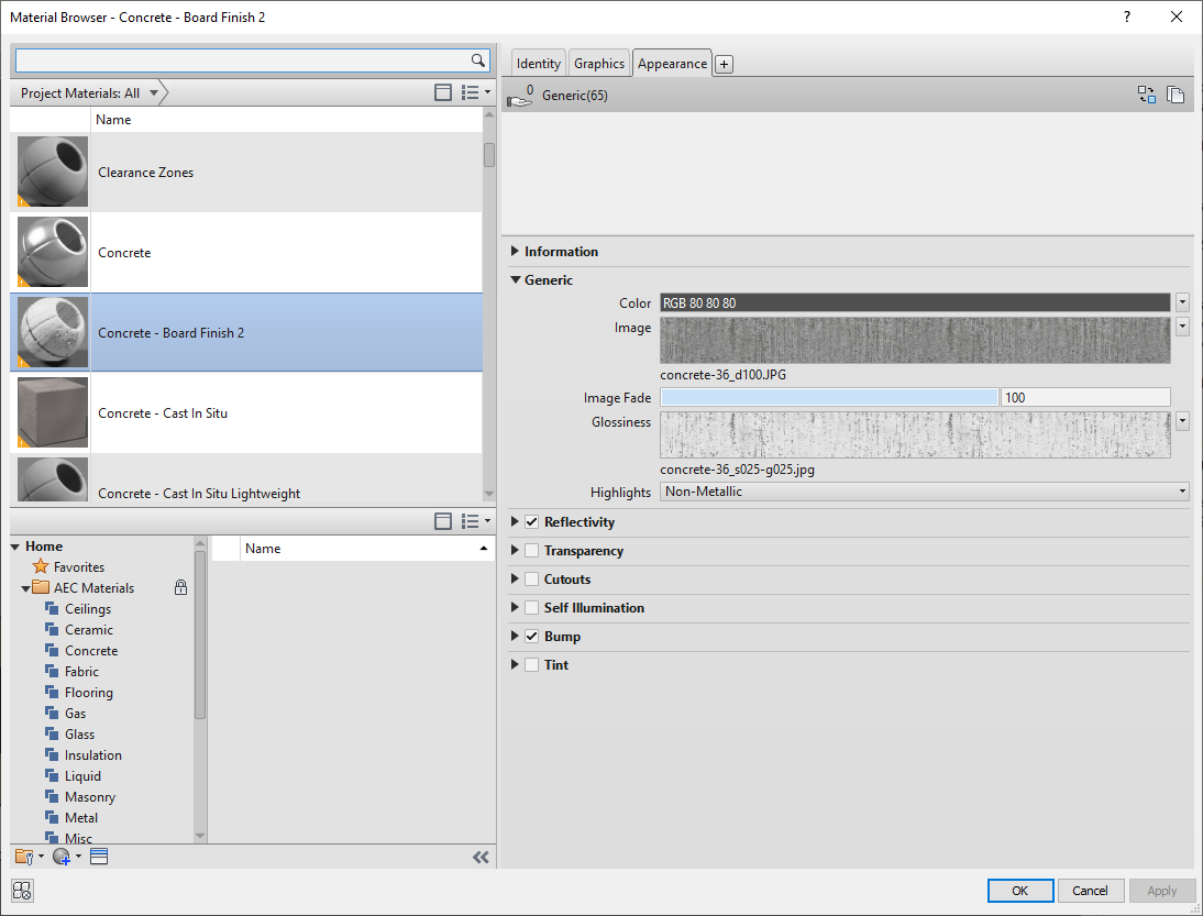

Revit material viewport

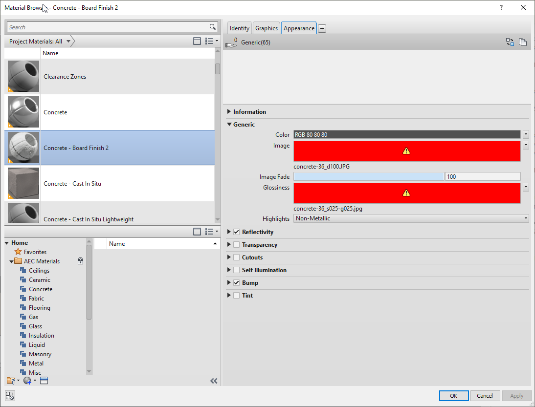

When you first open the file you will end up with missing textures everywhere.
Missing Materials
Missing Materials

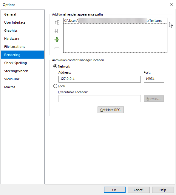

You do not need to re-path the textures manually, all you need to do is tell Revit where those textures are located, by going to Options --> Rendering --> Add links. I have included all textures for you to test as well. The catch is Revit cannot read Sub-folders so all textures have to be sitting inside 1 folder.
Repath Window
Repath Window
Once you have added the path all materials in the folder will be re-pathed automatically.

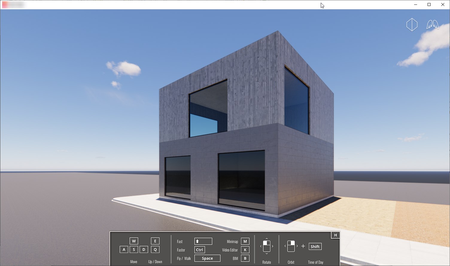

Now, since I also use Enscape. All I need to do is go to a 3D view (3D Ortho view is also okay!) and press "Start Enscape" - that's what we will see out of the box with no settings required:
Enscape just works without settings

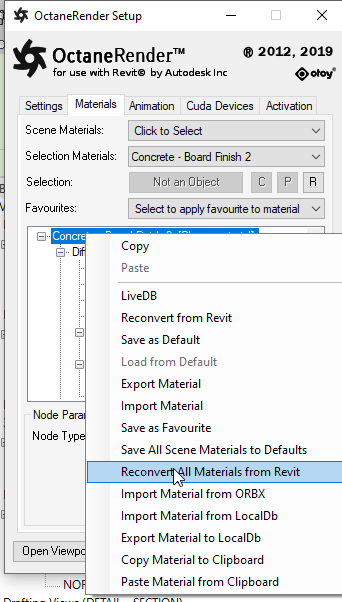

I then tried to Re-convert all materials to Octane material.
Convert Materials to Octane

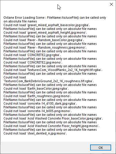

Finally I hit Open Viewport, and that's what I get:
First Octane warning

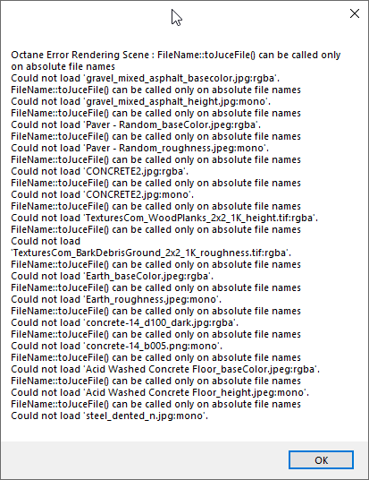

Then the viewport opened, and I get 1 more error:
Second Octane Warning
and that's what I see:
Octane View
Octane View
Could you please tell me what has gone wrong?

When you add the textures path to the Options/Rendering/Additional paths, Revit is still reporting that the texture map is missing in it's own Materials window, so this function appears to be bugged.

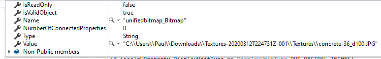

Inside the SDK, you can see if you add your path to the Options/Rendering/Additional paths, it only provides the relative filename, not the full path:
Whereas if you manually fix the broken link, the SDK provides the full path name:
So this looks like a Revit SDK problem to me. I have requested from Autodesk how to retrieve the list of paths added to the Options/Rendering/Additional paths window, which might provide a way for the plugin to get the full path name. However at the moment, you would need to manually relink all the textures in the Revit Materials window.
