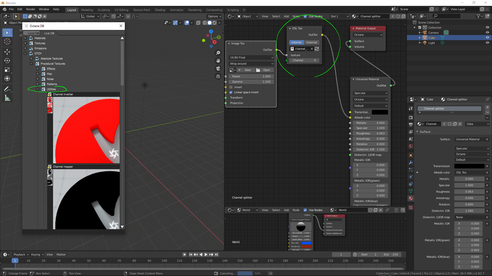

We can do that already using OSL.
You can download the Channel Splitter node from the LiveDB:
There are many other very useful nodes there.
This is the script:

Thanks Lino,
Unfortunately this does not work. I need to extract the alpha texture, which I'm assuming is the fourth channel, or in this case rgbTexture(3). I get a index out of range error, I'm thinking that it's because the rgbTexture function only allows 3 channels. I tried a rgbaTexture but there is no function. :(

It can’t be done in the splitter. It’s the way the texture file is loaded before it gets to the OSL script. Maybe in the future the dev will add the feature. Most likely it was done this way because the alpha is generally ignored most of the time and therefore why not save some processing time and memory. For now, the alpha image node is your best bet.

Yes, OSL doesn't provide acccess to Alpha yet.
