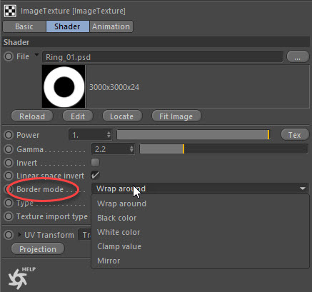

Logic is different for Octane. Tiling should be set from "Border mode" in ImageTexture nodes.

It's C4D's bitmap node. We don't use it, try to just use "ImageTexture" node under octane nodes. Otherwise, you cannot use the octane specific parameters and functionalities.
