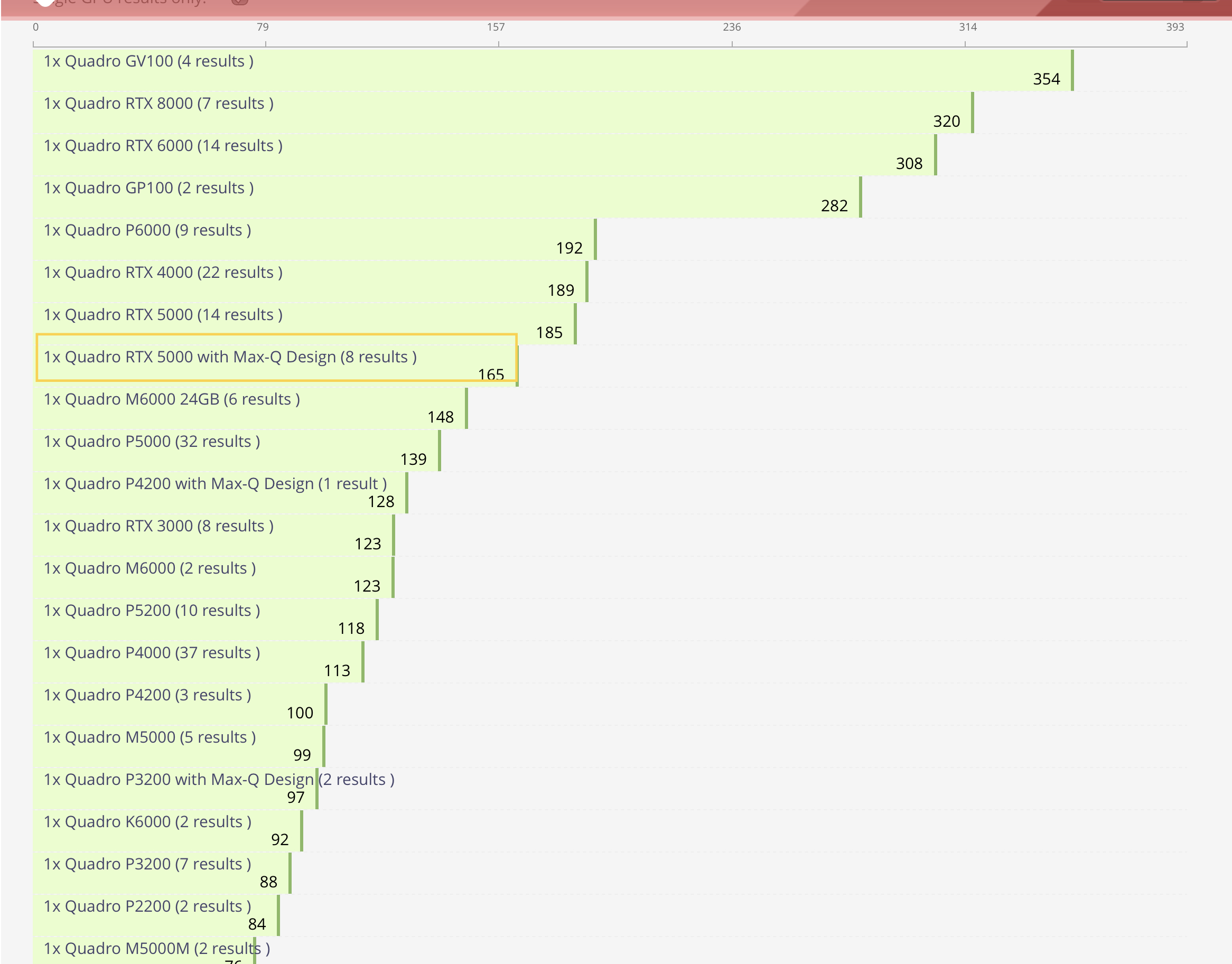

But there is a Quadro RTX 5000 with Max-Q Design that scores ~165:

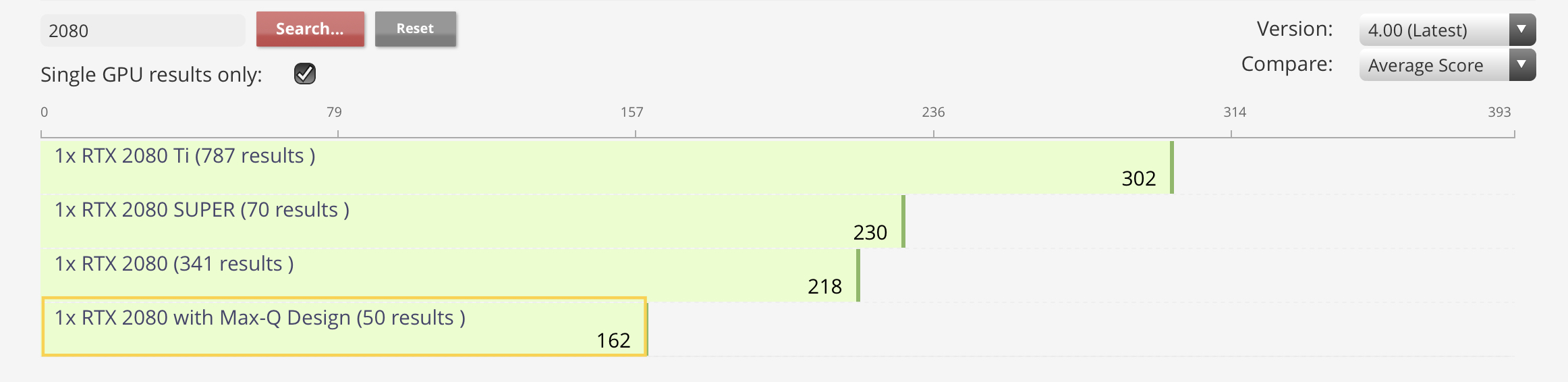

While RTX 2080 with Max-Q Design scores ~162:
and both have RTX acceleration, not yet measured in OctaneBench, while Quadro Max P5000 with Max-Q Design does not have RTX acceleration, so difficult to compare with RTX 2080 with Max-Q Design.
