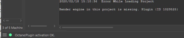

Render engine in this project is missing. Plugin (ID 1029525)
rocketstock
Posts: 10
Joined: Fri Mar 06, 2015 8:23 pm
The oct.dat file is now mirrored across the C4D team render and server folders in C:\Users\username\AppData\Roaming\MAXON\
This prevented any errors in the log when the TR server restarts, and the Octane:Plugin activation OK. icon
However, as soon as an Octane job is started, the following error appears in the log:
Code: Select all
2020/02/18 15:10:36  Error While Loading Project
I've attached a screenshot
