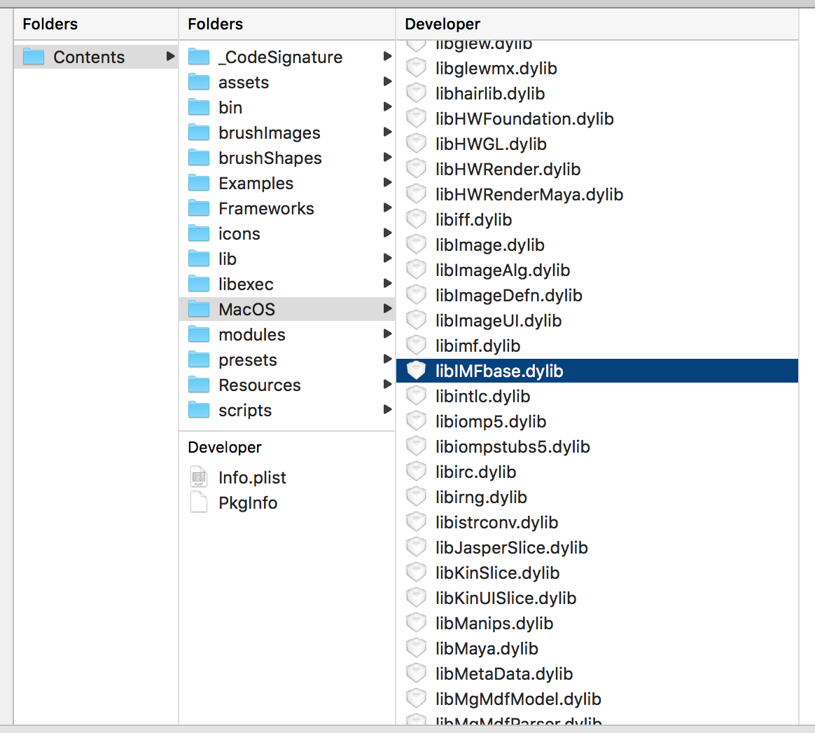

Trying to load the plugin in Maya 2020
// Error: file: /Applications/Autodesk/maya2020/Maya.app/Contents/scripts/others/pluginWin.mel line 317: dlopen(/Applications/Autodesk/maya2020/Maya.app/Contents/MacOS/plug-ins/OctanePlugin.bundle, 1): Library not loaded: @executable_path/libIMFbase.dylib Referenced from: /Applications/Autodesk/maya2020/Maya.app/Contents/MacOS/plug-ins/OctanePlugin.bundle Reason: image not found (OctanePlugin)
ANy ideas?
THanks

JimStar
Posts: 3837
p3taotoy
Can't check it right now from home - Saturday here...
But are you sure your Maya 2020 installation is not corrupted and has the /Applications/Autodesk/maya2020/Maya.app/Contents/MacOS/libIMFbase.dylib file in it?
Looks like this library file (required by Octane) is not loaded by Maya for some reason...

p3taotoy
Posts: 225
Joined: Sat Nov 24, 2018 1:06 am
Location: Washinghton, USA and Waikanae, New Zealand
Well that is a mystery... complete clean uninstall of ALL autodesk products.
Freshly downloaded Mac osx 2020 ( I am not aware of any upgrades yet are you?)
Same errors and that file you mention is not there.... I know it might be weird but can you zip yours and I'll put it in there to see what that does.... I realize yours may already be specific to your machine etc but I am wondering if a fresh install of the Maya Otoy plugin will overwrite the appropriate lines etc.
Just an idea cause I have no clue why this would be specific to my Mac Powerbook 15" 2017
High Sierra 10.13.6
Says my Nvidia driver is up to date: 387.10.10.10.40.105 last check 02/15/2020
This is a long shot... do you think an Nvidia card needs to be loaded and running during the install process? The file does not seem to be nvidia related... and come to think of it I did a fresh install with two 1080s hooked up and rendering fine in the standalone.
Welcome any ideas come work week.
Peter
JimStar
Posts: 3837
I don't have Maya 2020 and its SDK at home, but I have a suspicion that Autodesk might have excluded this library from Maya 2020 builds, spreading its functionality between other libs... I'll check it on Monday. If this is the case - I'll release a fix for OSX soon, getting rid of this issue... You can use Maya 2019 on OSX before this happens (I think Tuesday or Wednesday) - 'cause I would like to include another nice thing into the next beta release, which I'm working on right now...
