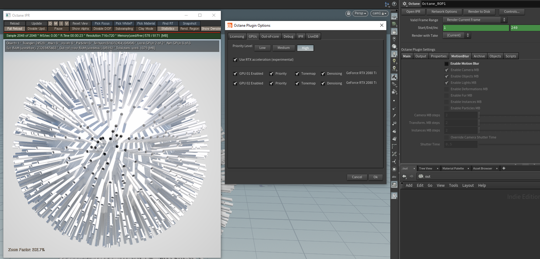

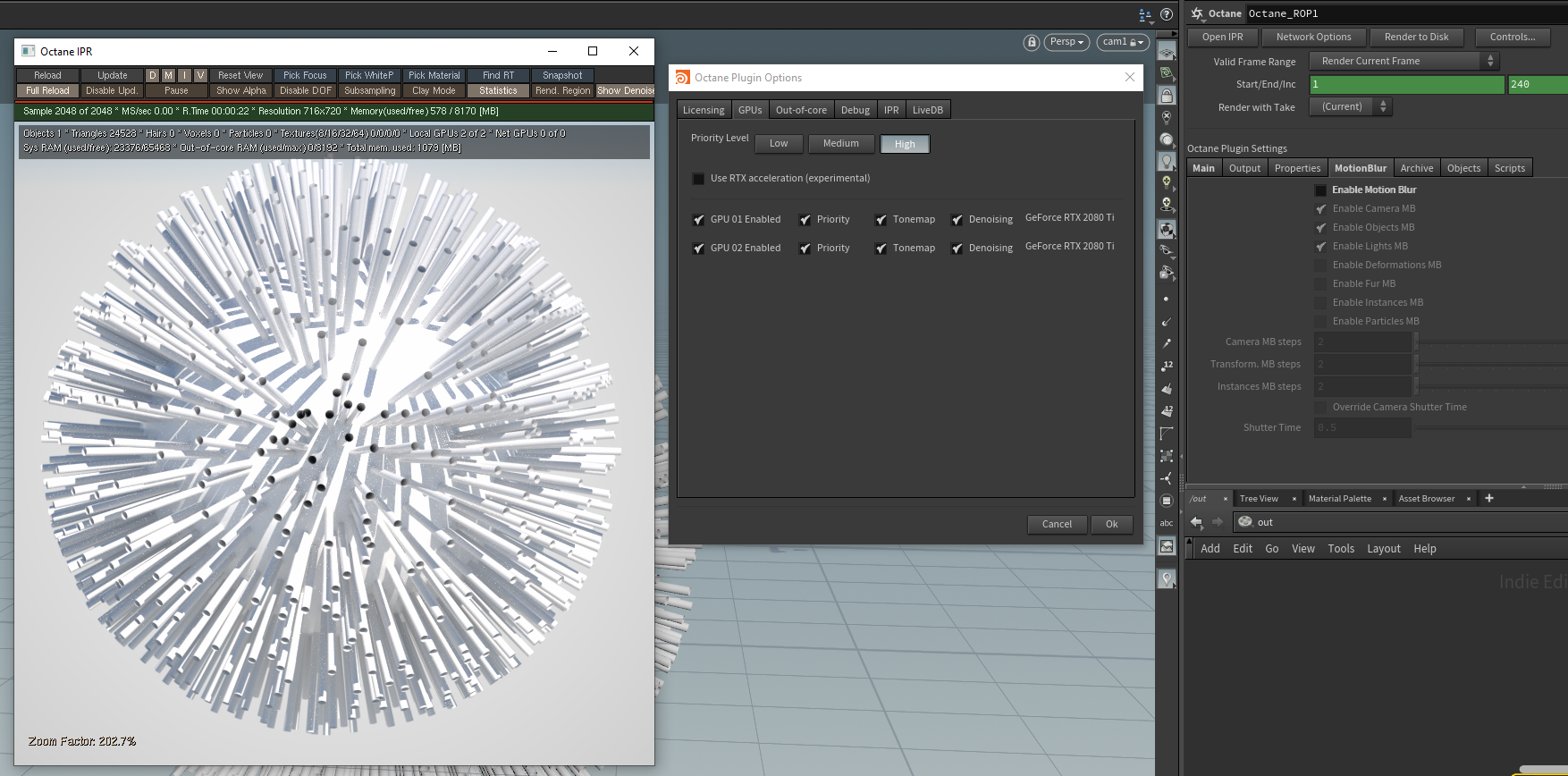

I'm struggling to see any RTX improvements in my test renders. I made a basic sphere with x1000 tubes scattered on it, and with RTX enabled the render was taking 1s longer.
rtx_test.zip
(1.92 MiB) Downloaded 172 times
I also exported the same object to the standalone and there there was a x1.45 speed increase. also brought the same obj into C4D and it showed the same speed increase with RTX.
I'm starting to think I don't have RTX enabled correctly in Houdini? I have motion blur disabled, I'm not sure what else to try.
Has anyone had this problem? Also had the same issues with XB1 XB2 and XB3

I opened up your Houdini scene with the 1000 extra instances, and I rendered it in 1 minute 11 seconds, and then I turned on RTX and it rendered in 1 minute and 12 seconds. So I think I am still missing something here. Maybe I'm not enabling RTX correctly?

Have you closed and reopened the IPR window after enabling/disabling the RTX option? A change in this feature needs a Octane restart, something that happens only when you open the IPR window or when you render to disk.

Make 100% sure you have motion blur DISABLED in the render options, and I mean everything unticked, otherwise RTX simply won't kick in.

Ok thanks for the help. i'm seeing the %50 speed increase now. I made sure the motion blur was disabled and completely reopened the octane live viewer, and things started working nicely. Also I noticed that in C4D there was a line in the render statistics that says if RTX is on or off, it might be nice to have that feature in the Houdini too eventually. Thanks again!
