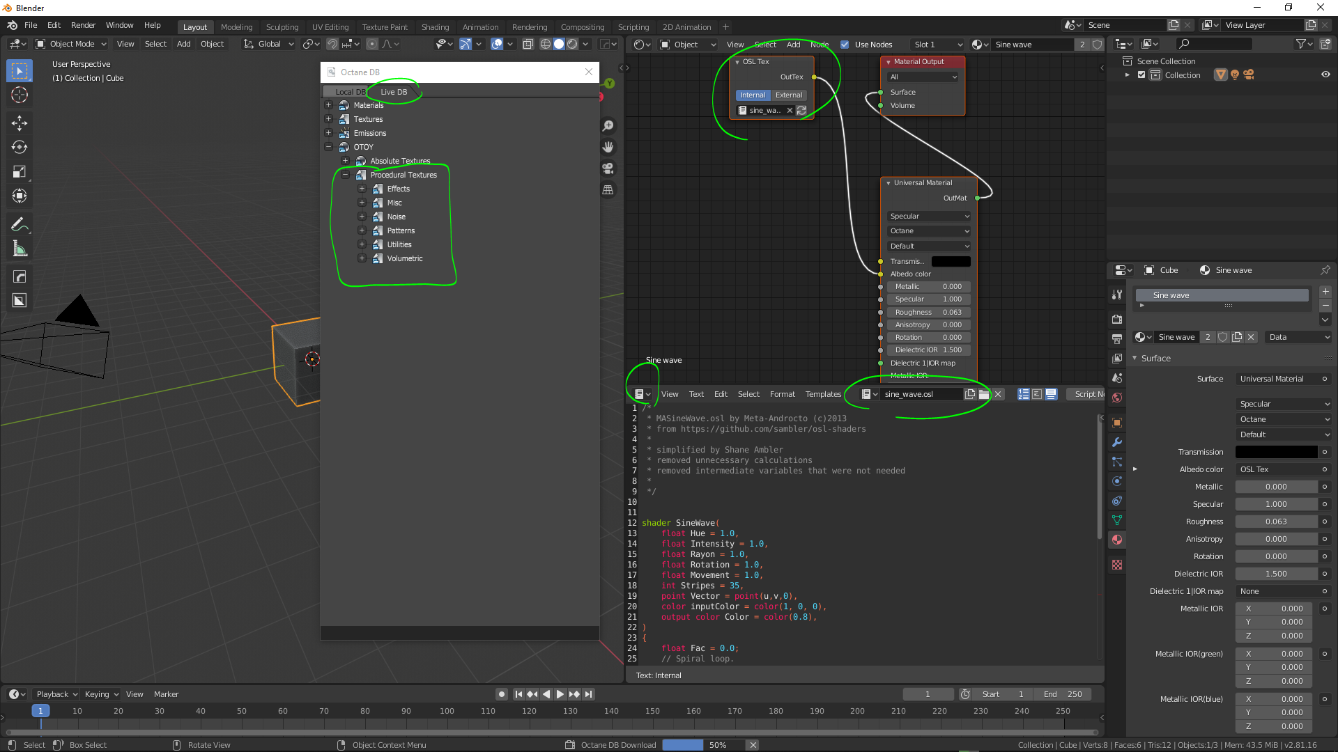

Any OSL script working in Octane Standalone will work in Octane for Blender as well.
You can always access an OSL script from a Standalone relative OSL node.
Also, you can find many OSL samples in the LiveDB you can download directly in Octane for Blender. The relative script will be there in the Text Editor.

Ah I knew somehow it must be accessible (o;
But I am right...OSLTex can only have one output which is of type color with no alpha?
Maybe I can use several OSLTex nodes for color, displacement and so on....
