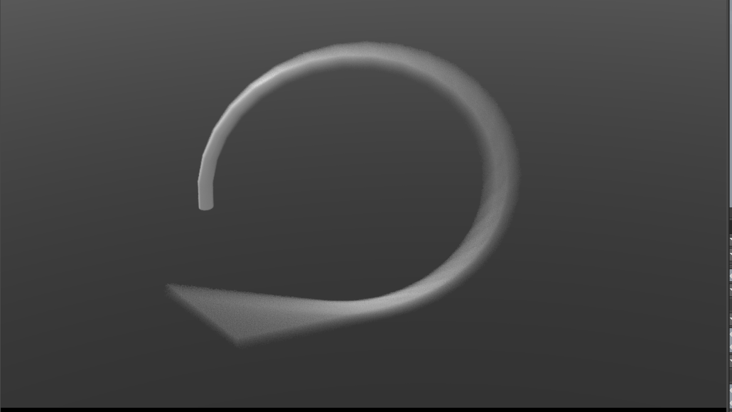

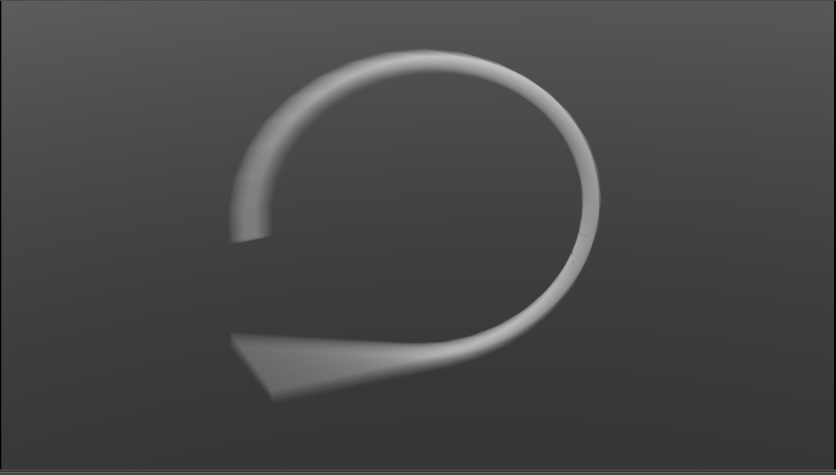

There is an example of the simple scene I made - bend deformer's motion blur in MODO an Octane (I've tested it in Octane 2019 and 2020). Seems like Octane is taking wrong action center for MB in the middle of object.
MODO:
Octane:
Scene is embeded
Wrong motion blur with deformers

Hi. The Octane plugin is obtaining motion vectors for motion blur via the Modo Render Cache. There is an outstanding bug report with Foundry regarding this where it appears the incorrect motion vectors are being provided by the Render Cache. I have provided your scene to Foundry as further evidence of this problem. The only way around this is to export the animation to an ORBX file and render in Octane Standalone - however I got an out of memory error doing this (which I have previously reported to OTOY, but not have a response on). I am sorry I cannot give you a better resolution.
Paul
