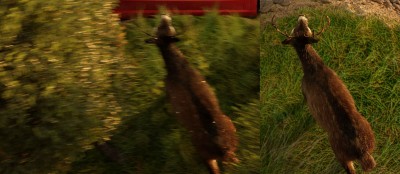

Hey guys,
I am rendering a scene with hair and every time I turn motion blur on (which I need for this scene) the hair on this deer goes crazy with artifacts.
Attached is a grab of the deer without motion blur so you can see the underlying setup and then with so you can see the artifacts.
Any ideas on this?
Win 10
Octane 2019.1.5
C4D R20.059
Thanks much,
Matt Hoffman
Posts: 16066
Location: Türkiye
TIME SAMPLING PER FRAMES
http://www.aoktar.com/octane/OCTANE%20H ... tings.html
and
Caching the hairs can help
