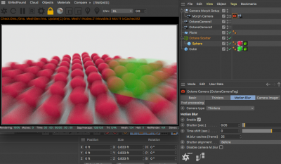

Which versions are you using? It seems to be working fine in 2019.1.5 with C4D R21. I just put the Octane Camera tag on the Morph Cam itself. It seems to do both camera motion blur and object motion blur. We don't do much vertex level motion blur, though, so I haven't tested that recently.
C4D Camera Morph Motion Blur - spheres are camera blur, green cube is transform blur
