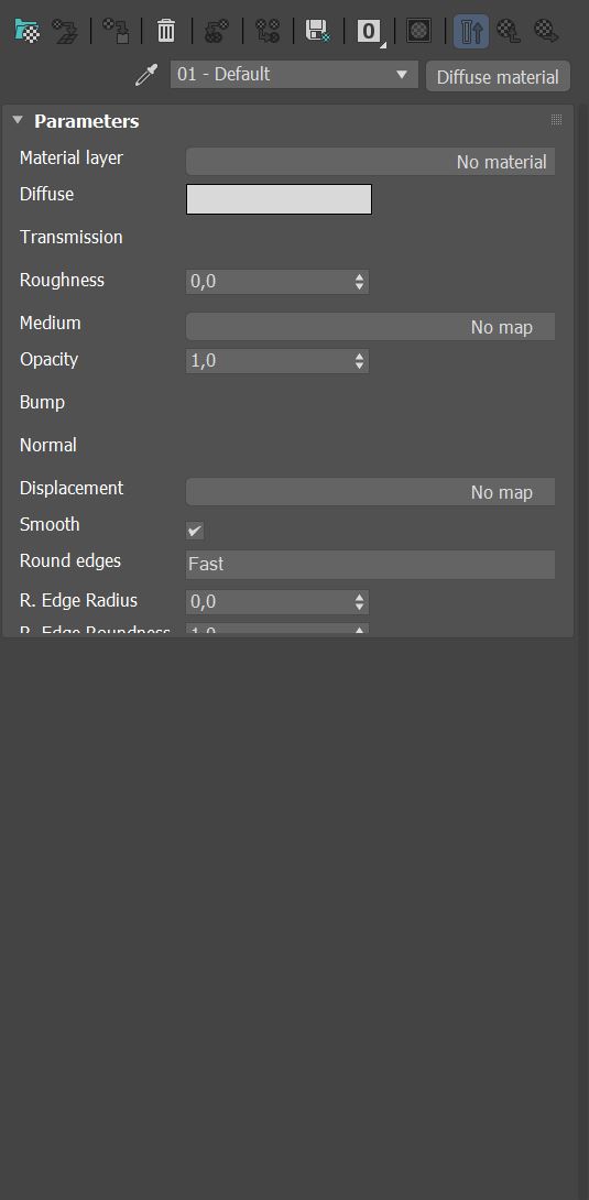

I have screen with 4k resolution and i have scaling for apps texts etc 200% in windows display settings. Everything works fine with previous octane versions from octane 4 to octane 2019 but with 2020 material editor is missing the bottom part and there is no side scroll. If i display scaling 200% then i lose bottom half of octane material editor, with 150% scaling i lose one third.
Everything works fine without scaling but 1920x1080 resolution is ridiculous for my 43" screen and with 3840x2160 resolution without scaling everything is so tiny so i cannot use it.
Is there some button somewhere where i can solve this issue? I tried to look octane plugin settings but i could not find anything helpful.

Scaling with material editor doesnt work
