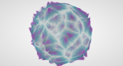

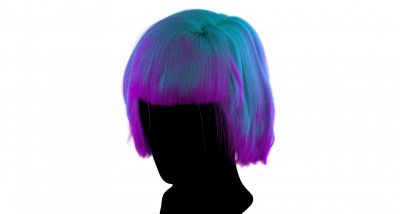

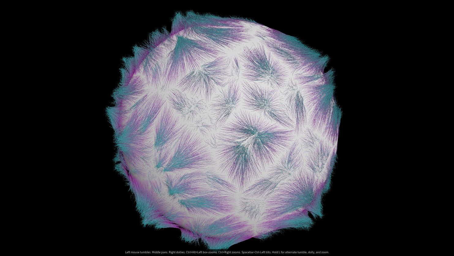

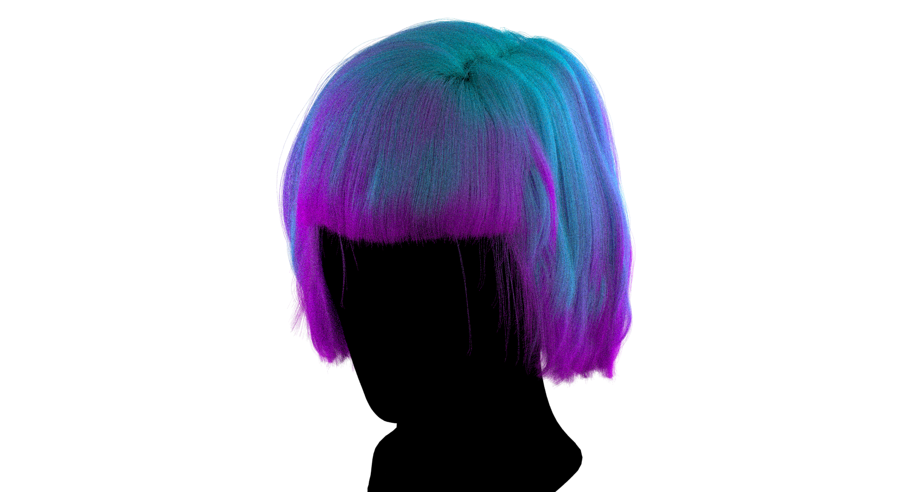

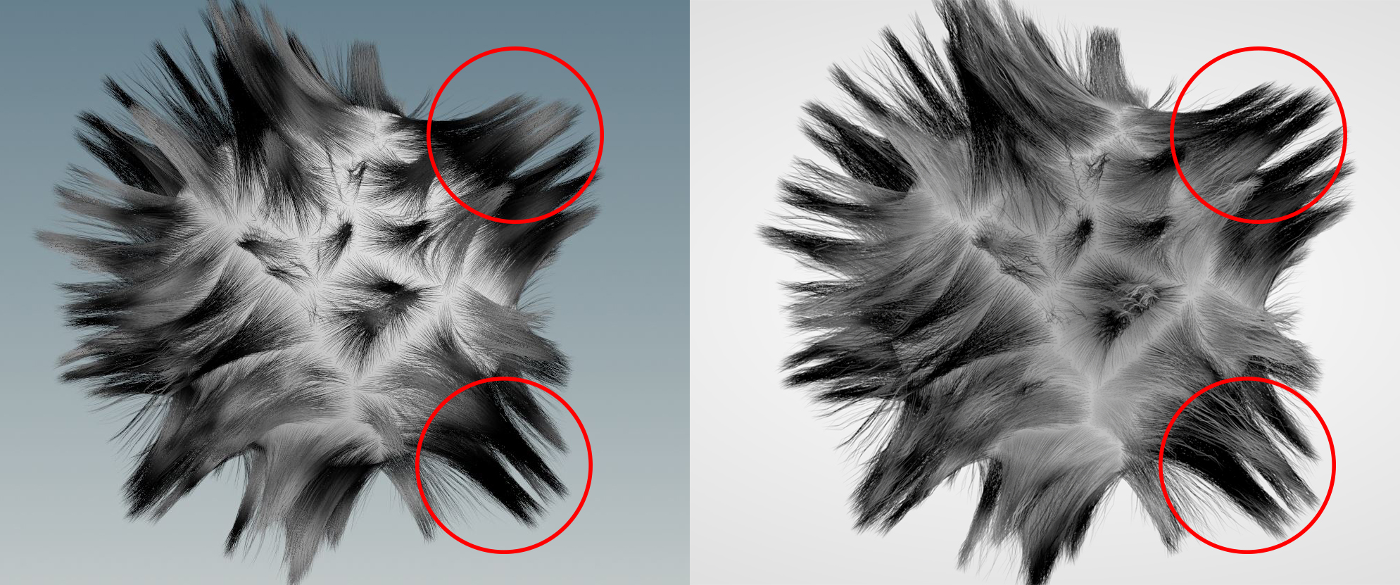

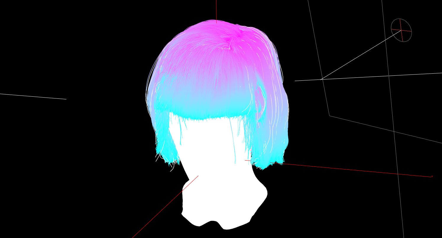

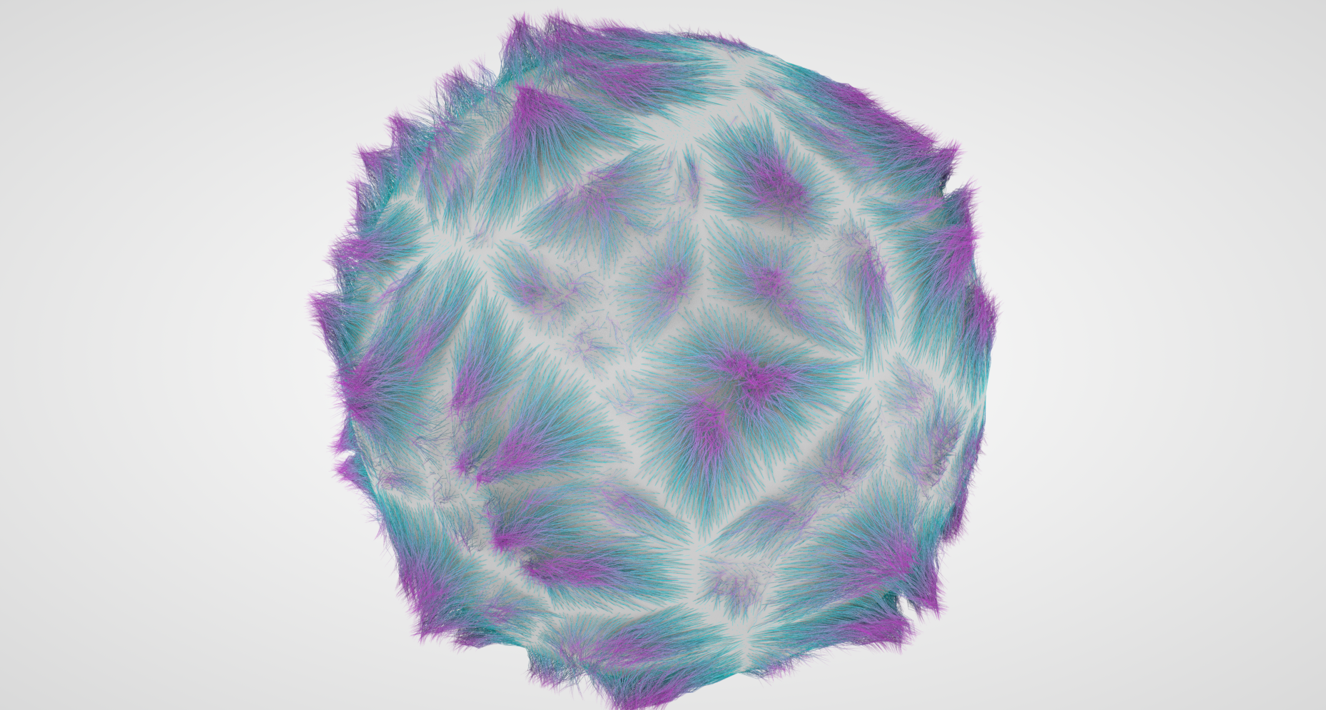

Color attributes for Hair works kinda but there are bugs. Looks likes it inverts the colors.
EDIT1: Ignore this for now. It seems its a problem with my setup cause it works fine on some other example i did. Needs further testing i guess.
EDIT2: Ok so, after further testing i've come to the conclusion that there are bugs. Some parts are fine and some are incorrect as you can see in the attached image (TEST_003)
in the examples TEST_001 and TEST_002, the bug happened when i tried to do a gradient.

Can you share your test scene to take a look at it here?

Here you go. Btw it works just fine in standalone.

which version of houdini are you using? 17.5 ? 18 maybe? have you tried in the other? due to the rapid API changes lately in 18 I have had other things break in 18 only. (fixed now in recent builds but was previously) so I would be great to compare just to be sure.

I'm using 17.5.460

I think that I've found the problem with the inverted attributes in the curves. I'll fix it for the next build.
Thanks for reporting it!
