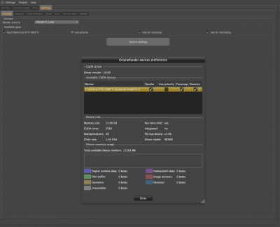

please go to Apple menu, About this Mac, then press the System Report button, then go to menu File/Save, and share the resulting .spx file, thanks.

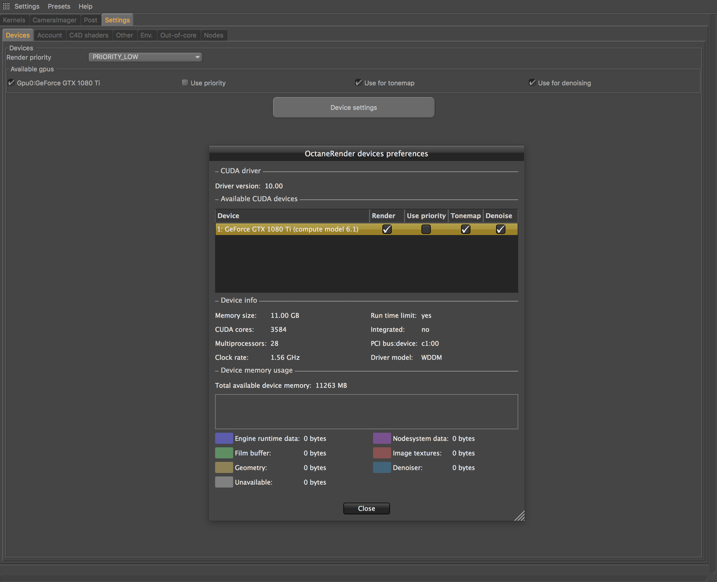

Please, also post a complete screenshot of c4doctane Settings/Devices panel, thanks.

stefano-dear
Posts: 123
Joined: Mon Apr 04, 2016 12:06 pm
bepeg4d wrote:Hi Stefano,
ciao Beppe
Hi Beppe,
I'm sending you the required files.
Thanks a lot!
Stefano

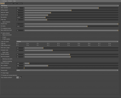

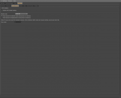

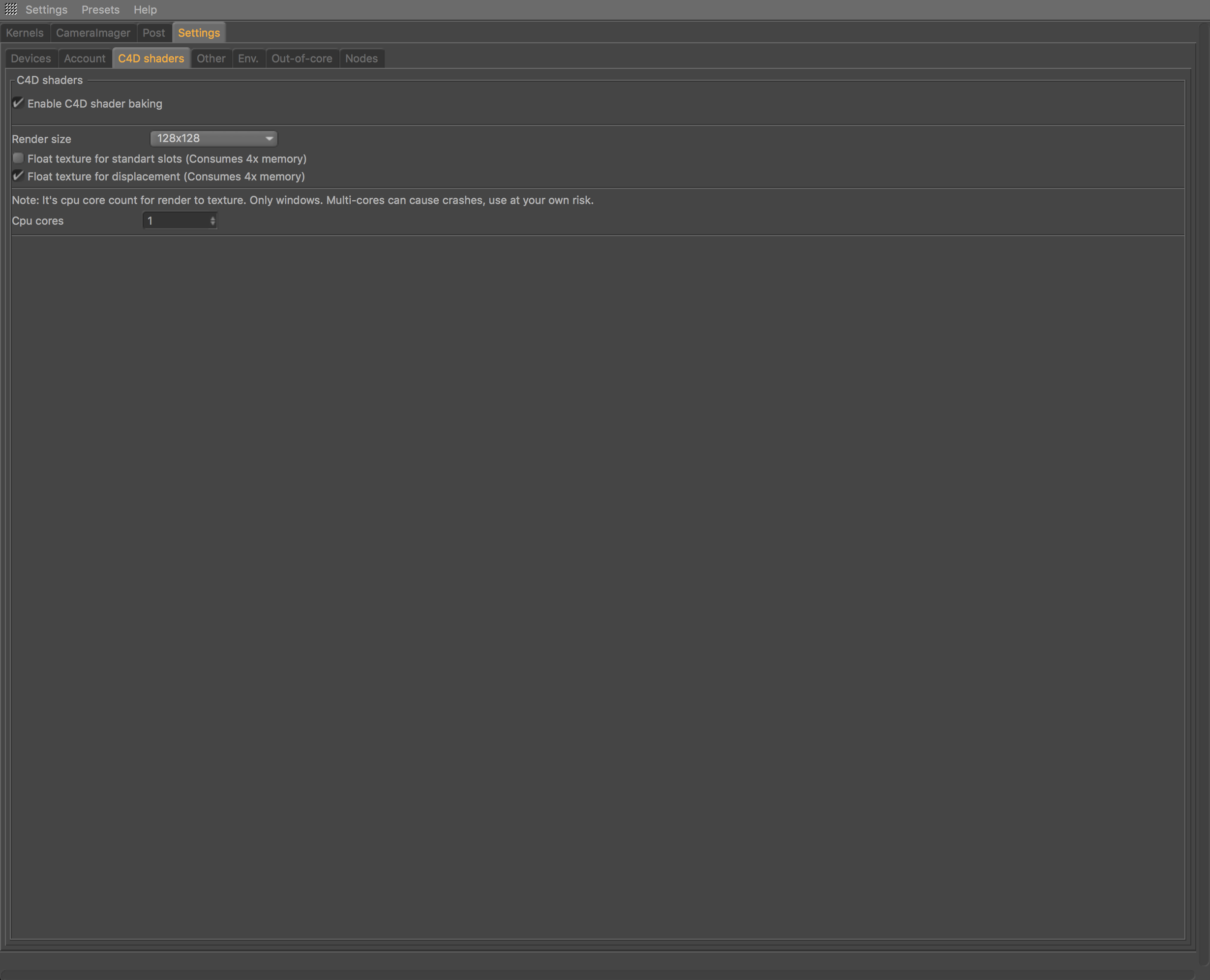

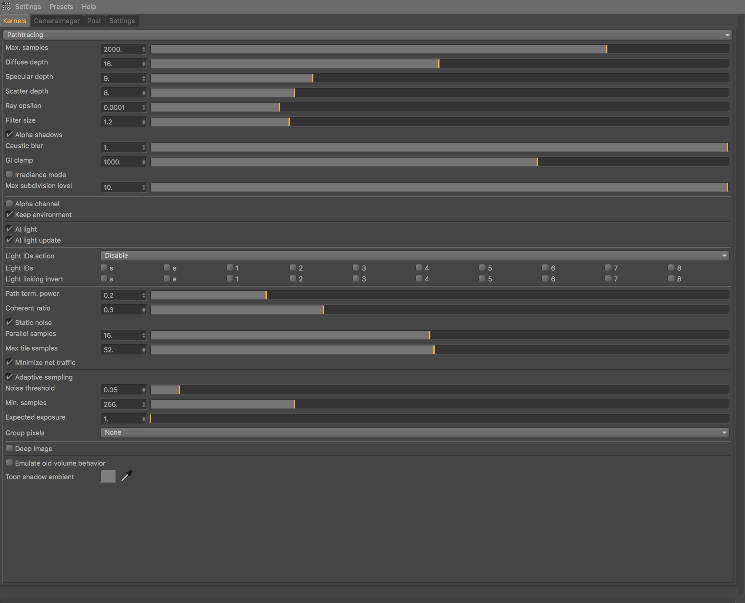

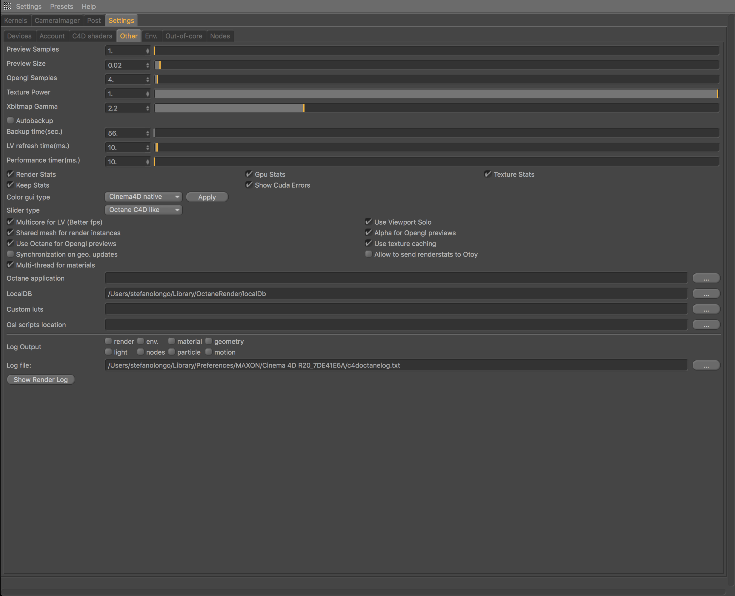

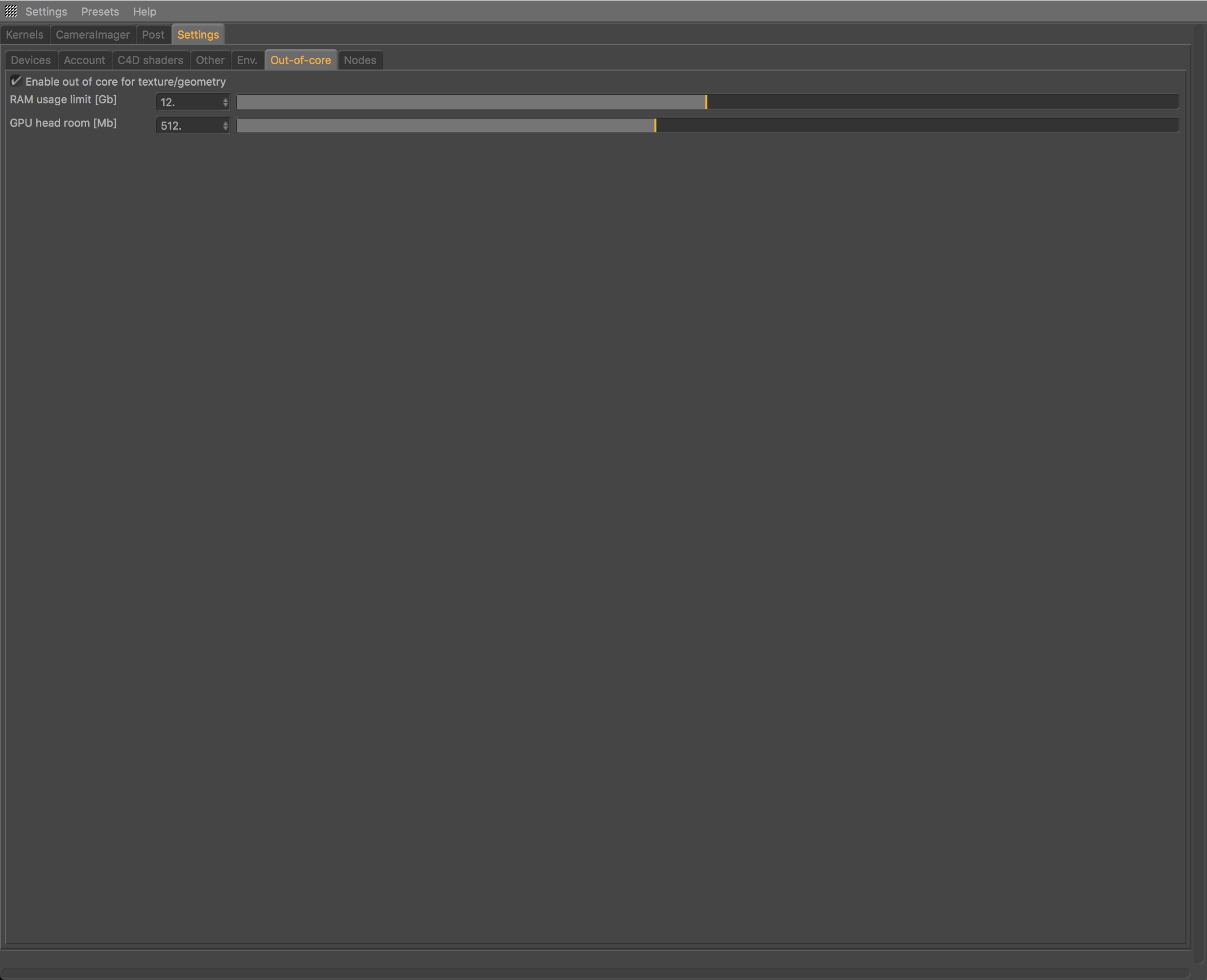

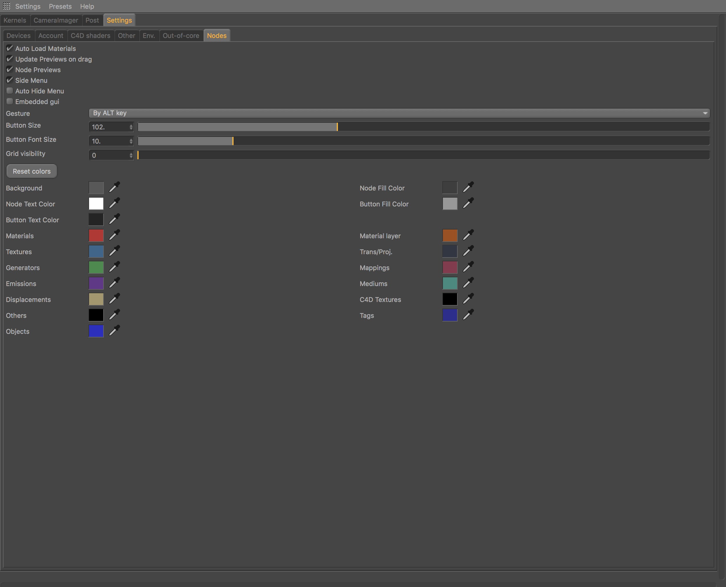

Thanks Stefano, please also share a complete screenshot of the Others panel, thanks.
ciao Beppe
stefano-dear
Posts: 123
bepeg4d wrote:Thanks Stefano, please also share a complete screenshot of the Others panel, thanks.
ciao Beppe
Yes Sir!
