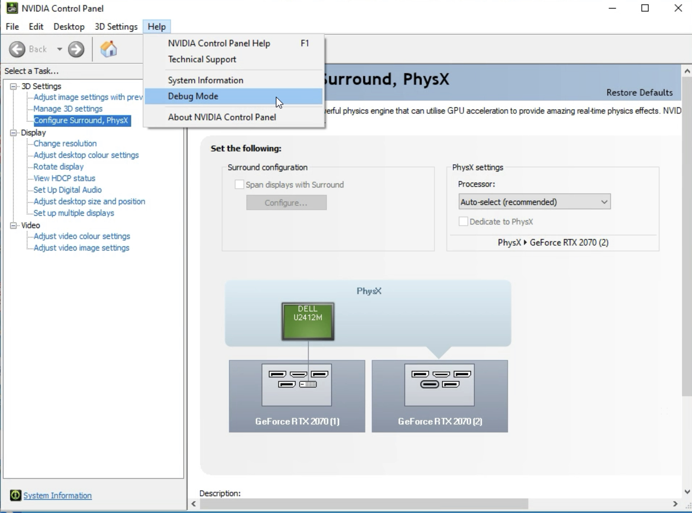

If not enough, go to Nvidia Control panel, menu Help, and enable the Debug Mode: ciao Beppe
