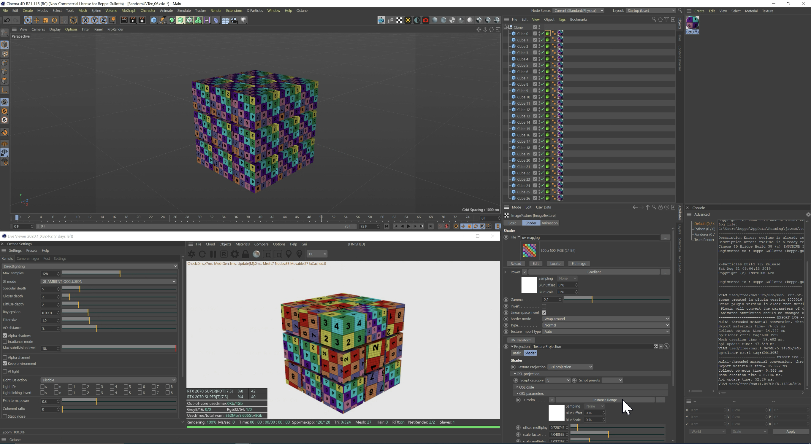

you can do it also with c4doctane, with a couple of clicks.
Select all the desired objects, apply an Octane Object tag, and enter num in the Instance ID field, to assign a different sequential number to each object.
Then use the Instance Range node to pilot a gradient, or an OSL random projection node:
ciao Beppe

But where is the OSL random projection node? Can only see 'OSLProjection' which doesn't seem to do much...
