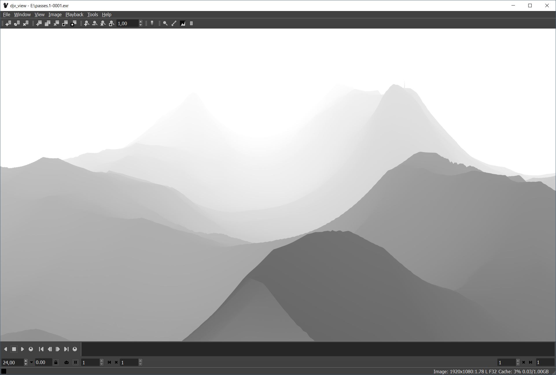

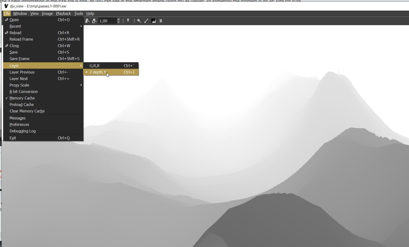

I've just rendered your scene and the z pass information in the EXR file is fine, as you can see in the attached image using djv as viewer, so somehow the problem is on AE side for sure.

But this is the render from your scene, without any change in it! I've just rendered it and as you can see the zdepth information is there, at least when the file is opened using djv ...
