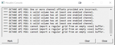

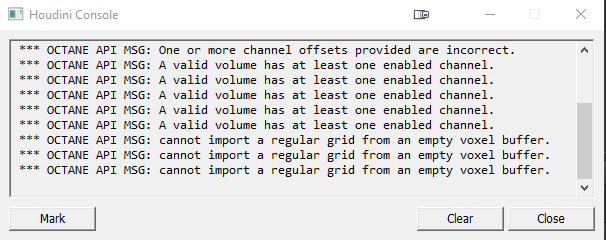

I have a problem rendering a pyro sim in Houdini 17.5.391 using Octane 2019. No idea what causes it. I have Cached the sim to disk, not sure if that matters. I get the same issue when caching to RAM.
The render is displaying correctly in the IPR but when writing to disk, I get an error message. Im gonna attach the message and hip file below.

You can ignore the octane messages. They come from the scene cleaning functions and are not dangerous at all. I've removed them for the next Octane 2020 plugin build.
