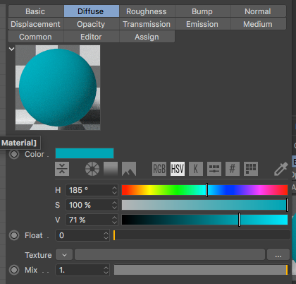

Where are you seeing -1 to 1, Jay? I see 0 to 360 degrees in the HSV option. I couldn't get the range you're seeing with the various combinations of Golor GUI Type and Slider Type options in Octane Settings/Settings/Other.
I may be misunderstanding.
Hue Range
Hue Range

Sorry, I was referring to the color correction node, not the color picker...

Ah-ha! Yes, Jay, I see what you mean.
Ahmet, it seems to make sense that the Color Correction node's Hue slider/range would be one of the interface elements modified by Settings>Color GUI Type, and Settings>Slider Type. How often do you really need six decimal places of color correction precision in shader setup? And if you do need it, you can alway switch back to the -1 to 1 picker.
