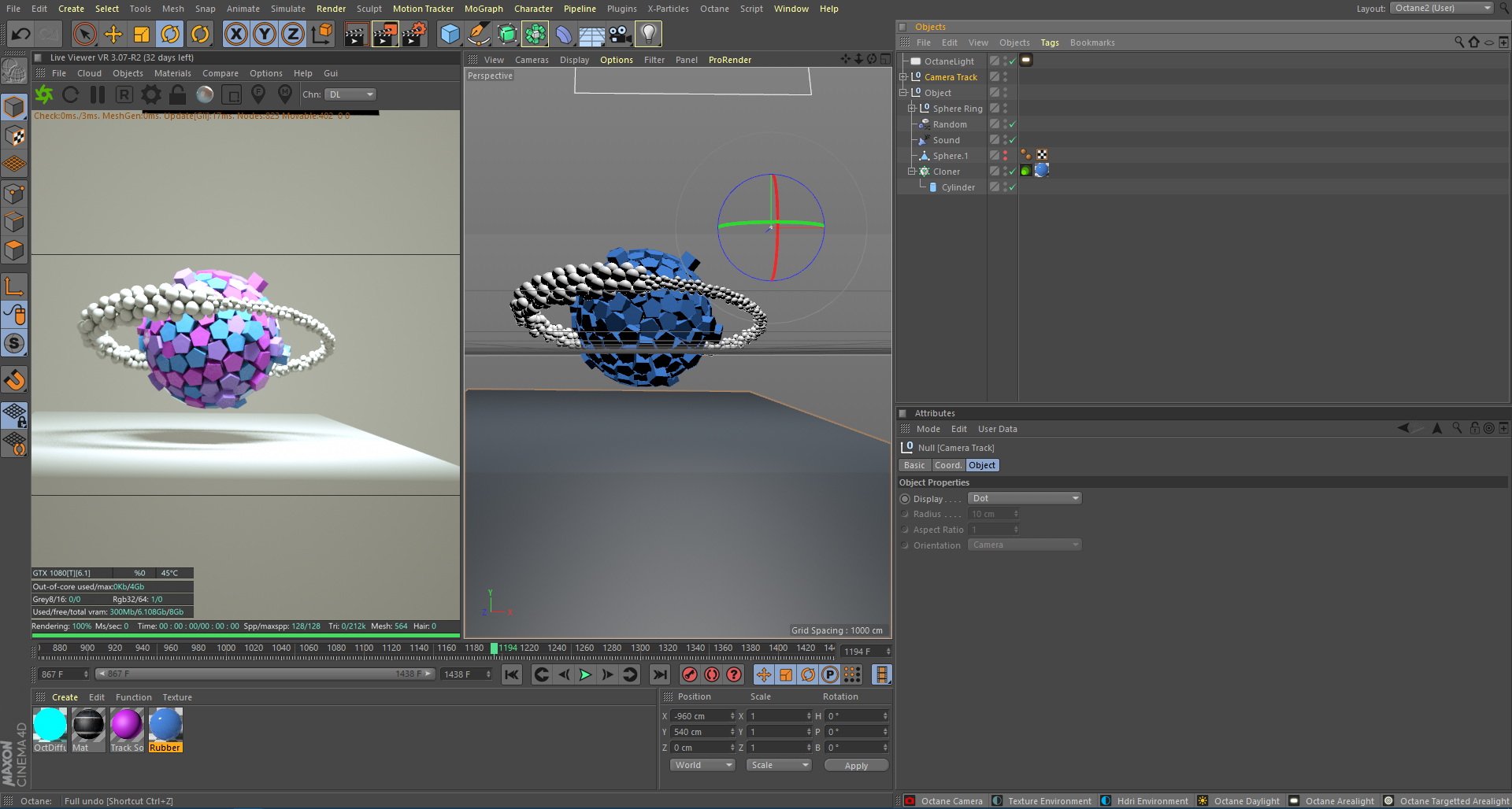

I have a simple scene where I have pentagonal prisms cloned into a sphere. They are reactive with music using the sound effector. What I would like to know is, how can I make it so the colour of the pentagonal prisms is based on their height from a gradient?

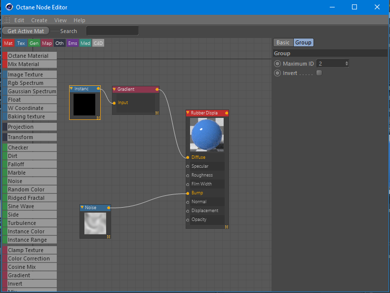

Jonathann
Posts: 4
Joined: Sun Oct 16, 2016 3:52 pm
I've figured it out now thanks. I'm using the colour gradient setting in the sound effector, through a instance colour to drive the diffuse
