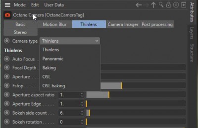

I am trying to use the fish eye camera in V4.05-R7 in Cinema4d R17.055 but after setting the camera mode to fisheye and adjusting the fisheye angle nothing happens in my live viewer or even in the regular picture viewer. Is there something I need to activate to get this to work properly?

Universal camera is not a part of V4, added in 2018. Probably you have a bad version with wrong parameters. It shall be fixed on a later build.

that's interesting, I wonder why it appears for me in Cinema if it isnt actually there. So if I dont have all access there is no way to use the universal camera?
